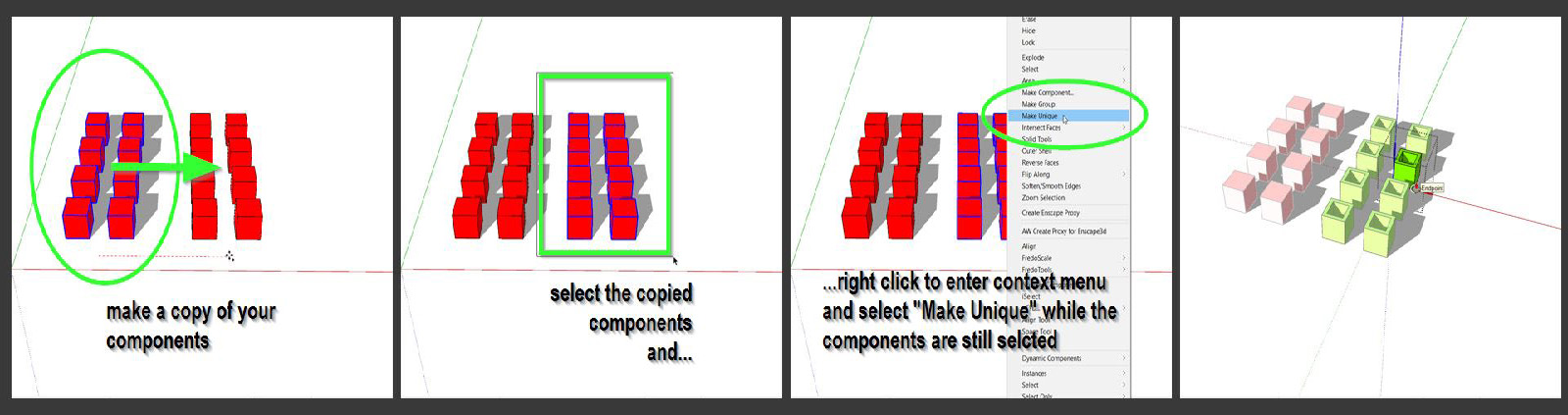

          • HornOxxH
            HornOxx
            hope that helps
            never trust a skinny cook

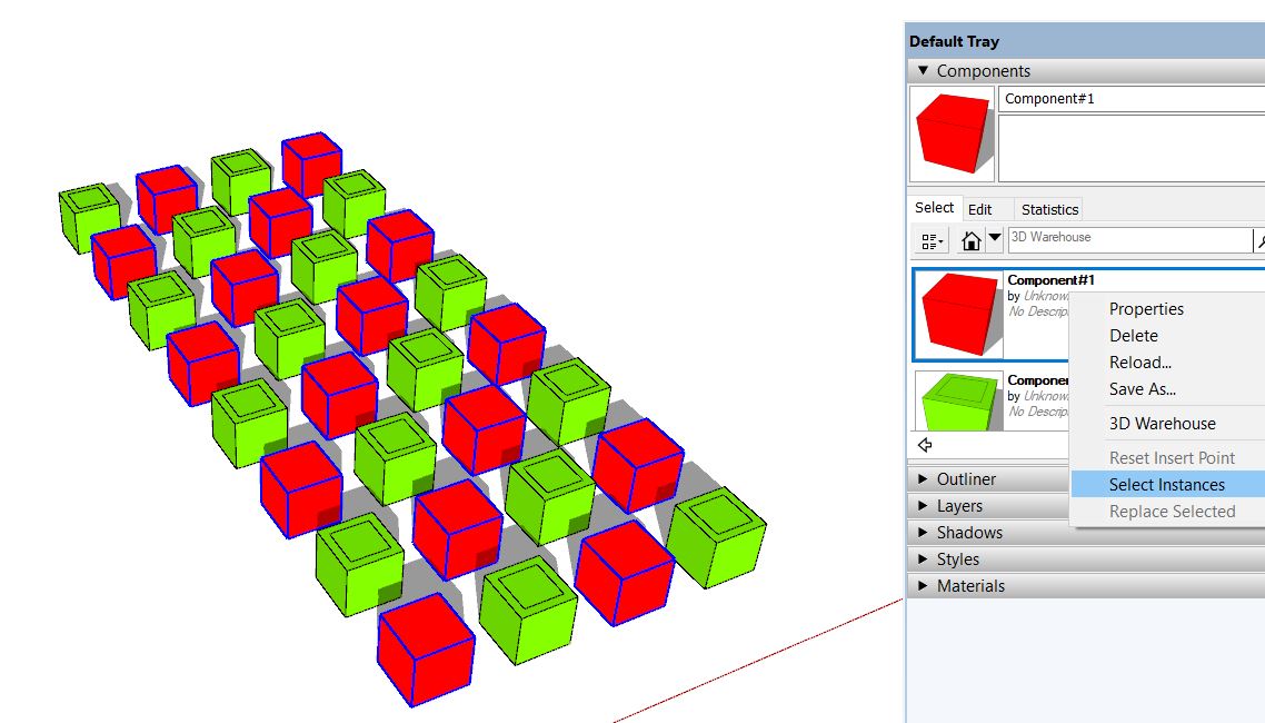

            • HornOxxH
              HornOxx
              ... or another approach could be to use the SU´s Component Window or the Ouliner - the right tactics always depends on the task to do 😉

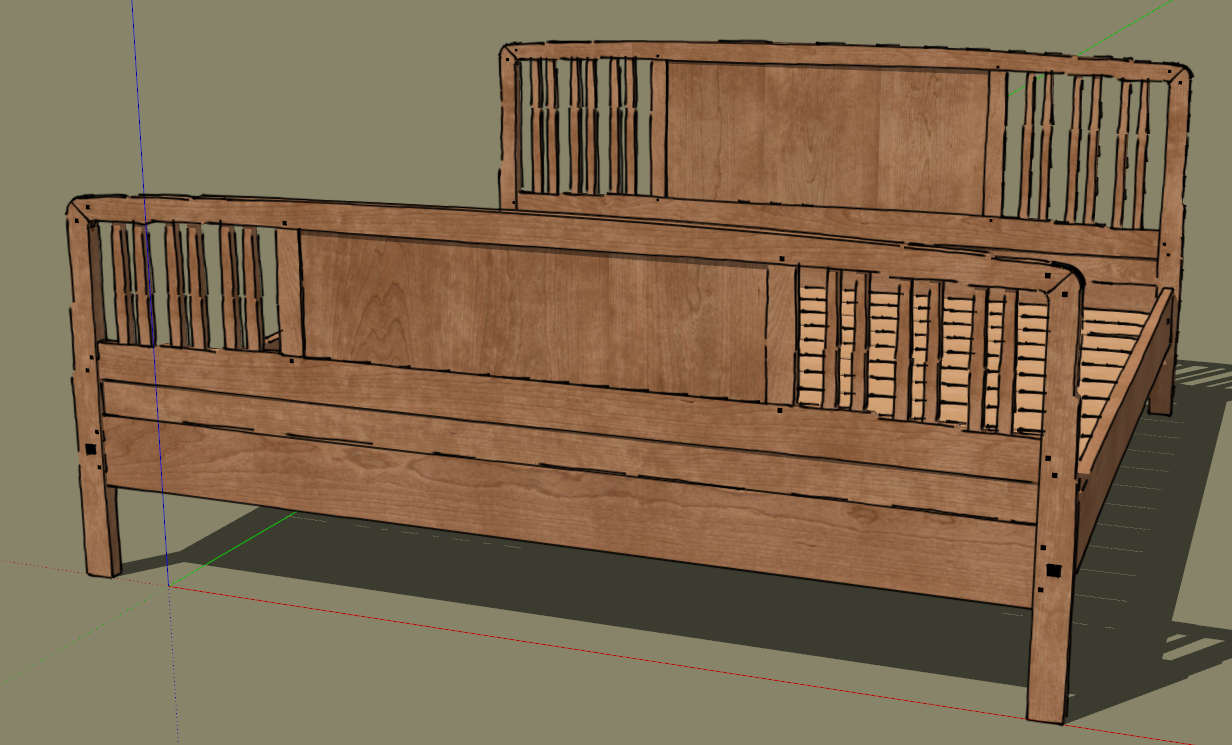

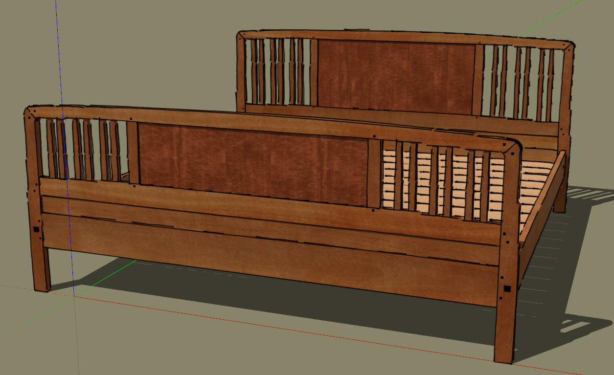

                      One way that I do this sort of thing is this.
                      1. Set up the model with the first materials options. Here I've got a bed in mahogany.
                      2. Copy (CMD-C on Mac) all of the components that will need to show a different material. In my case it's all except the ebony plugs and splines and the slats to support the mattress.
                      3. Assign a layer tag based on the material to the currently visible components. I made a layer tag called 'mahogany' for this example. If you need to you can group the components together and assign the layer to that group instead of to the individual components.
                      4. Turn off the visibility for that layer.
                      5. Paste in place. This puts copies of the component in the same locations as the originals.
                      6. Immediately, while the pasted components are selected, right click on one and choose Make Unique.
                      7. Apply the new materials to the faces in the components.
                      8. Create and assign a a layer tag for the new material. In my case I used cherry.
                      I would make scenes with the different versions visible so it's easy to switch between the different materials.
