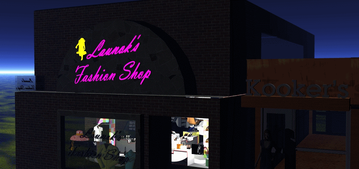

      I am trying to search for tutorials on how to make a sign and text into neon style look (3D). Unfortunately all the videos I ran across needs extra plugins/tools such as LightUp to get such results. I do not have funds to buy any of these plugins/tools and will have to do without it. Even VRay I can't afford at this stage which make things a bit difficult.
      Are there any other ways to get such a neon look without the mentioned plugins/tools and VRay? I have downloaded neon videos for Blender but have to admit I am absolutely clueless about Blender. Not that I know much more about Sketchup either, but have built 2 shop buildings in Sketchup and that way have some knowledge over Blender. Sketchup seems a bit more user-friendly comparing the interfaces.
      I want to add titles and signs to my buildings in neon style. I have done so with post work by using Paint Shop Pro (second image) but 3D will be much better on the end! I actually hate post work! πŸ˜’
      https://2.bp.blogspot.com/-LAkVeLzCfbg/WjJ0Zd8k_8I/AAAAAAAAA2I/mjK-P1N6T6on0Ugb8FbJFiR2OlFN6mltgCLcBGAs/s1600/2nd.jpg
      One of my Sketchup buildings which is available at the Warehouse.
      https://4.bp.blogspot.com/-x7gmn710qqc/WKwmJJWhWjI/AAAAAAAAApU/lW-j9Uo5M1opVi_w86xE6HfZNBePYNDIgCLcB/s1600/Animation1%2B-%2Blaunoks%2Bfashion%2Bshop3.gif
      Another Sketchup building (also at the Warehouse) but animated shop title with Paint Shop Pro's Animation Shop (post work).
      Both scenes rendered in Bryce 7.1.
      Any help will be greatly appreciated! πŸ˜„

        You can find neon sign style fonts or maybe already have some. Use 3D Text to create the sign lettering. You can't create the glowing appearance in SketchUp other than using a bright color. If you want to make the lettering look like it is illuminated and illuminating its surrounds, you'll need to use a rendering program. Maybe you could try Kerkythea. It's available at no charge. Since you haven't completed your profile with SketchUp version and OS, I don't know if Kerkythea is an option for you, though.

            You could look at Twilight renderer Hobby. You can do a lot with an "emissive material" (a texture you apply to the surfaces which can cast light in a render). With "bloom" settings you can give a glow appearance. It's comparatively easy once you get an idea how the rendering app works. You could work with flat surfaces first and you might find that you don't have to do tubes or ropes of shapes to get the effect you want--depending on the detail you need and how close the view is to the subject.
