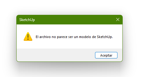

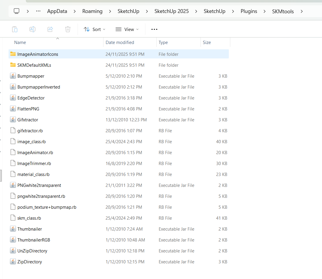

                Hi im having a similar problem. When i execute image trimmer, it says please wait but then another sketchup window opens with this error, "it doesnt look like a sketchup file"
                • TIGT
                  What are you trying to do ??
                  Please read the full guidance notes.
                  Simple checklist...
                  You need a model with a PNG image installed, which has some transparent pixels which get deleted. It also needs the the other solid pixels to have no transparency at all.
                  You need the SKMtools installed to give you ImagerTrimmer.
                  ImageTrimmer uses some java applets [.JAR files] to do image manipulation.
                  You need JAVA installing to use them.
                  Some people get problems because the compression-app is set to open them.
                  Also [as it appears in your case] you CANNOT have the .jar file-type extension associated with any other program.
                  Perhaps in your case looks like it's been given over to something like WinRar.
                  When you install some compression/decompression programs the default set of file-types which they are set up to open often includes .jar - which is actually a re-suffixed ZIP file - just like a SKM, Style or Layout file.
                  To stop this happening, open WinRar's preferences and un-check [unassociate] that .jar file-type, save changes and close WinRar.
                  Now retest ImageTrimmer in SketchUp and see if the .jar applets execute properly [rather than open]...
                  If you set the JAR files to open in SketchUp it will not work - so delete that option.
                  • N

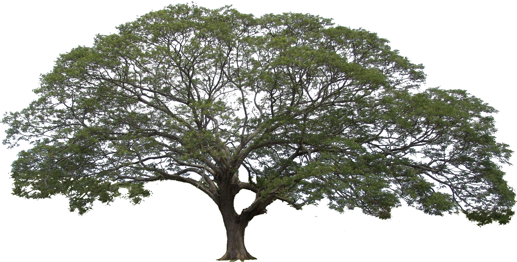

                    Hi TIG I'm trying to trim this image, but everytime I use the plugin, sketchup freezes and I have to force the program to close.
                    Dave RD 1 Reply Last reply
                    • Dave RD
                      Dave R @Nicklaus Tang
                      @Nicklaus-Tang said in Image Trimmer Plugin issue:
                      That isn't a surprise. You're asking the extension to create many thousands of edges. That will take a long time. You could speed it up some by eliminating the excessive detail with a simpler silhouette.

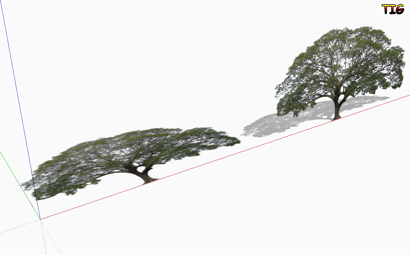

                      • TIGT
                        I tried it with my very old ImageTrimmer, and it took a very very long time !
                        Then I tried it with Fredo6's new https://sketchucation.com/pluginstore?pln=Pic2Shape
                        It took 25 minutes, and I had to manually hide the edges and stand it up, but it worked well. Here's the SKP v2026... trimmed.skp
                        1 Reply Last reply πŸ‘
