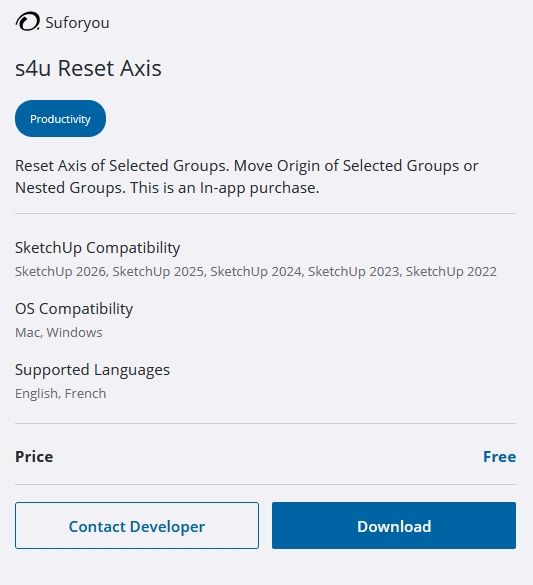

            rv1974
            SU4U > Reset Axis
            sumasterS Didier BurD 2 Replies Last reply πŸ‘ Reply Quote 0

                • Didier BurD Offline
                  Didier Bur @rv1974
                  @rv1974
                  It doesn't work on my side, I get this:
                  Error: #<NameError: uninitialized constant S4U::S4u_License
                  Did you mean? SCFLicense>
                  ..../sketchup/plugins/s4u_reset_axis/s4u_reset_axis_code.rbe:374:in `main'
                  ..../sketchup/plugins/s4u_reset_axis/s4u_reset_axis_loader.rbe:26:in `block (2 levels) in module:S4u_reset_axis'
                  Any hint ?
                  DB
                  R 1 Reply Last reply Reply Quote 0
                    rv1974 @Didier Bur
                    @Didier-Bur wild guess- the trial is over and you need to purchase?
                    Didier BurD 1 Reply Last reply Reply Quote 0
                      Didier Bur @rv1974
                      @rv1974
                      the script is supposed to be free...
                      DB
                        rv1974
                        Yep, I hate this part - they are too shy to indicate it's commercial, they ALL are FrEe. Here on sketchucation they do show $ sign
