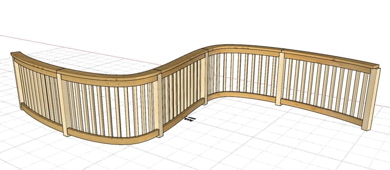

      Currently there is no "curved" railing option yet however with a little bit of adjustment of the parameters and simply following any given set of points you can do this sort of thing:

                Turns out there are many possible solutions to the problem when you go from a single arc to a Hermite biarc solution. Of course not all these solutions are useful, especially where they intersect or collide with other segments of the polyline. Quite the education on this topic between Wikipedia and ChatGPT yesterday. Here as some solutions to the biarc and single arc problem:
                wall_su1255_800.jpg wall_su1258_800.jpg wall_su1259_800.jpg wall_su1261_800.jpg wall_su1262_800.jpg wall_su1263_800.jpg wall_su1264_800.jpg wall_su1265_800.jpg

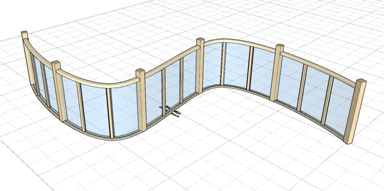

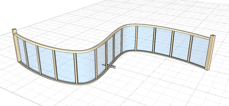

                        Version 4.6.7 - 06.25.2026
                        • Added a “GLASS” baluster option for curved and straight rail assemblies.
                        • Added a “CABLE” baluster option for curved and straight rail assemblies.
                        wall_su1278_800.jpg wall_su1279_800.jpg wall_su1282_800.jpg wall_su1288_800.jpg wall_su1289_800.jpg

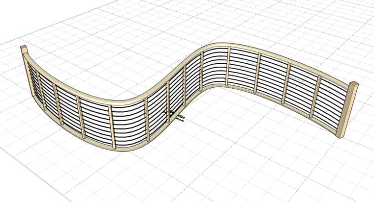

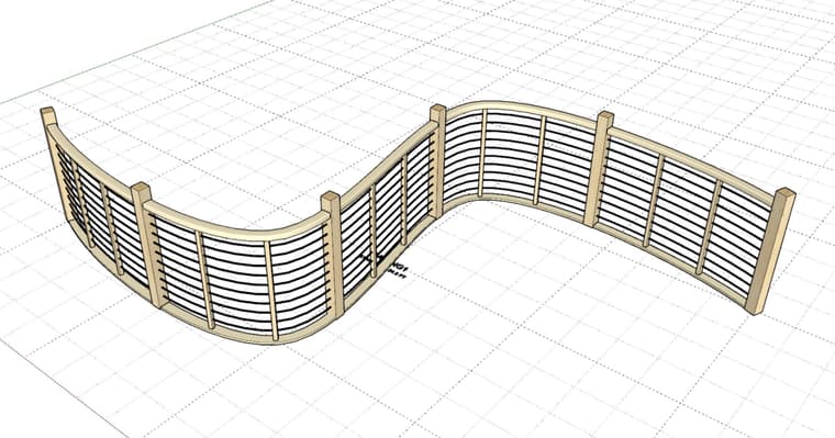

                          Version 4.6.7b - 06.26.2026
                          • Enabled deck railing for spline railing assemblies.
                          • Added a "GLASS" baluster option for spline railing assemblies.
                          • Added a "CABLE" baluster option for spline railing assemblies.
                          wall_su1290_800.jpg wall_su1291_800.jpg wall_su1292_800.jpg wall_su1293_800.jpg wall_su1294_800.jpg
