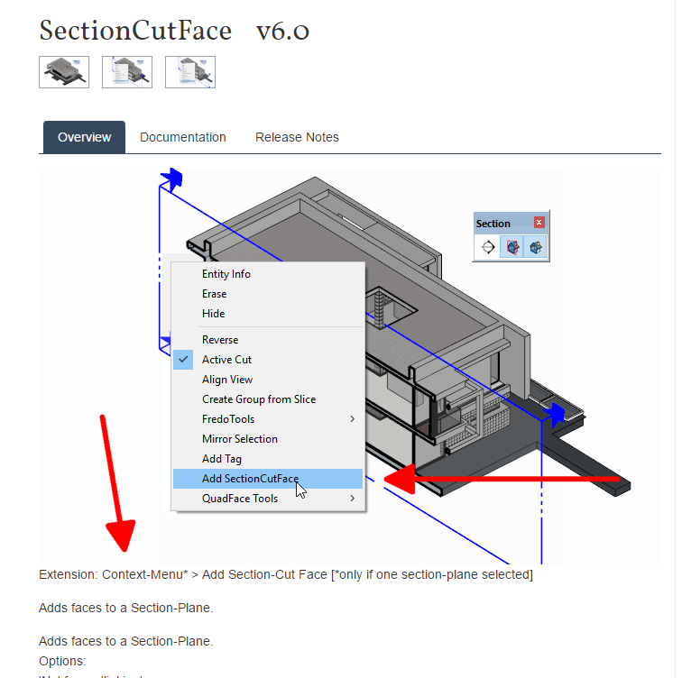

            • Dave RD
              @greggb67 said:
              I found it under the Sketchucation plugin manager but do not know how to make it run.
              The instructions for use are provided on the information page for the plugin. It will be found in the Context menu when you context click on a section plane.

              • TIGT

                One somewhat unusual thing with SectionCutFace is that it has no menu/toolbar entries.
                But if you select a single Section Cut Plane and right-click... the context-menu will then offers you the options to add the SectionCutFace, and depending on its type/settings you can also choose to remake it etc... @DaveR beat me to it... his illustration shows the detail...
