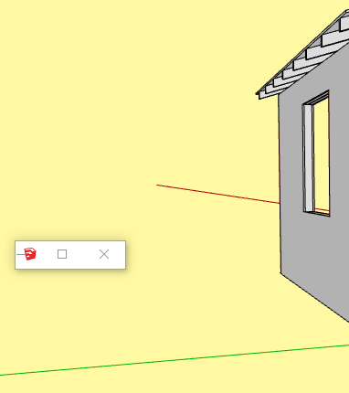

        Works fine for me in SU16 except for:
        1. The dialog box opens as just a bar which needs to be stretched out to see the input options
        2. The corner options pictures do not appear when selecting a corner type
