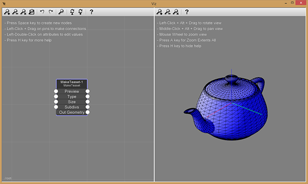

                                  We just released a new version of Viz, you can get it here
                                  In this new version:
                                  • Improved GraphEditor look
                                  • Fixed Mac issue
                                  • Added more primitives, such as Cone, Sphere, Teapot, Cylinder
                                  • Added a node to create lines from an array of point positions
                                  http://www.fluidinteractive.com/wordpress/wp-content/uploads/2016/08/MakeTeapot.png
                                  • genki.ttG
                                    genki.tt
                                    Thank you for rapid release !
                                    I could open VizPro on Mac !
                                    I could see the tea cup that has a big hole on bottom !
