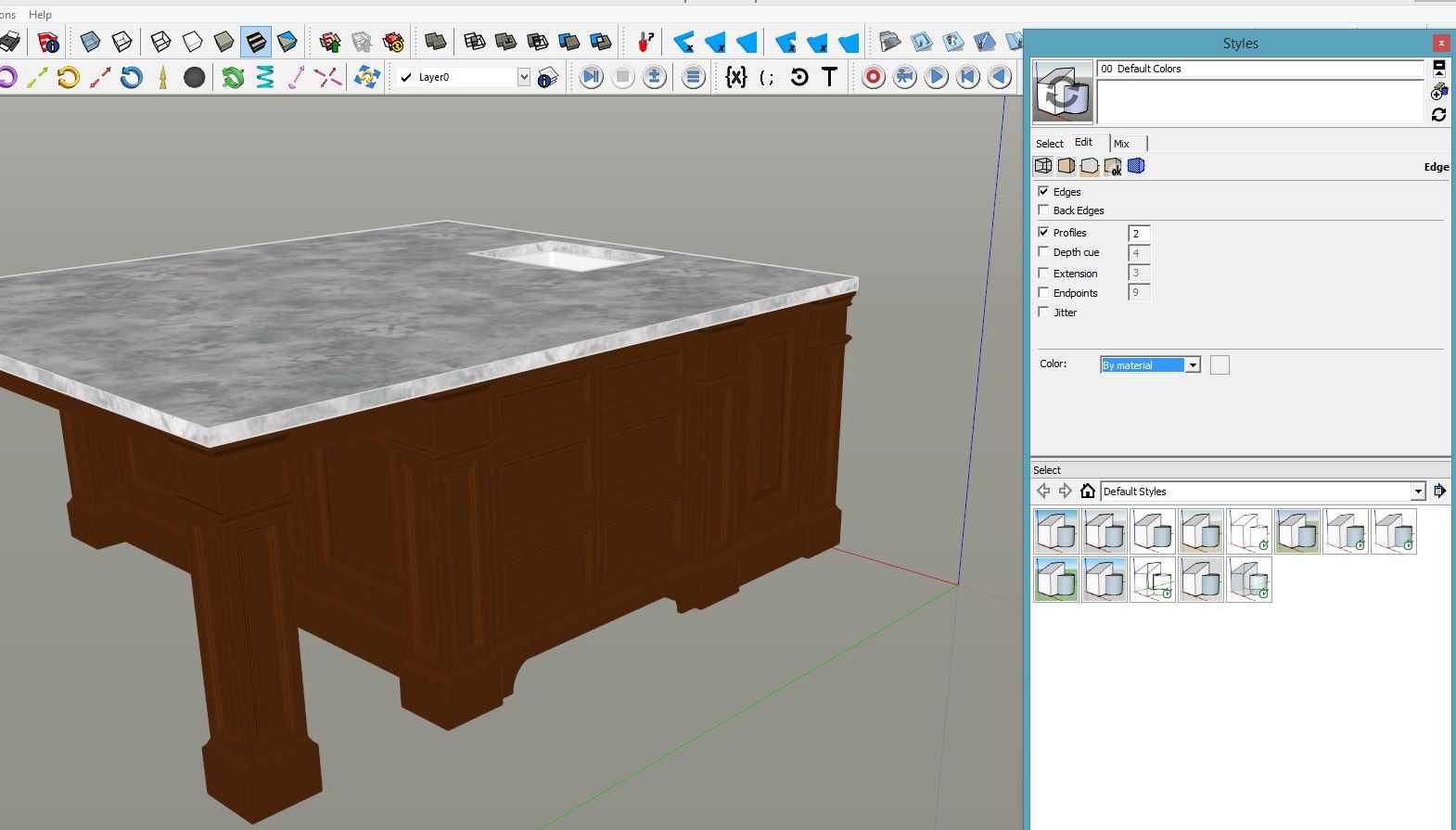

      When I color a model the black outline disappears making the detail harder to see. I have gone to Window--> Style--> Color--> All Same and committed the change. When I save the file though, the black outline disappears again. I'm sure this is a simple setting but I wasted several hours trying to figure this out. Any insight would be greatly appreciated

        Go View/Edge Styles and untick Profiles.
          It sounds to me as if you aren't updating the style after you set the edge color to All Same. After making the change (and make sure the edge color is set to black or whatever color you want them to be) click on the style's large thumbnail in the upper left of the Styles window.

            Thank you for the quick response. I tried that but it didn't work. Here is the really odd thing. With the Styles window open, I change the color to "All Same" and the lines show up perfect. I then update the style by clicking on the upper left box or the right upper chasing arrows. When I then save the file the outline disappears and the color has been CHANGED back to "By Material". I have save this over and over and can't get it to stick. I would be happy to share the file if you think you could figure it out.

                    Thank you! If you go to Window -- Styles -- Color -- All Same the black outlines appear. I can commit the changes but when I save my file to the computer it reverts back to "By Material" every time. I'm sure its something simple but I have wasted and embarrassing amount of time trying to fix this for presentations with clients.

                      He is a screen shot of what happens including the Styles editor function to the right.
                      Thanks again!
