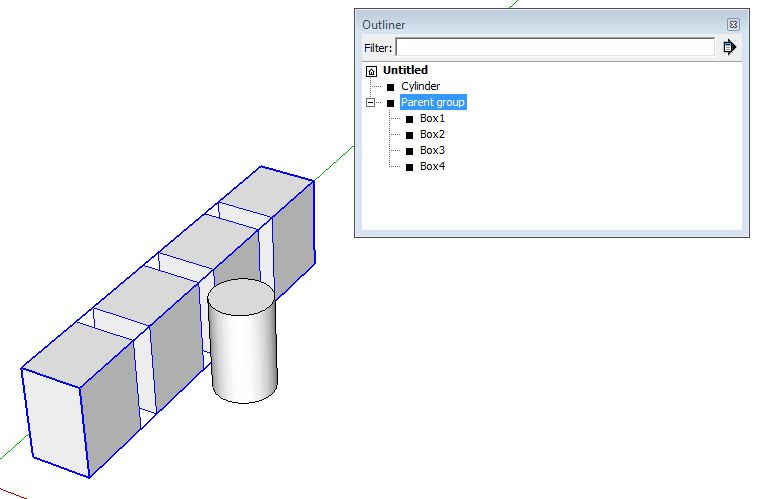

                thanks - my problem is not solved though. if i create a group, later another group within this group (a subgroup?) and later want to extract this subgroup, how do you do this??

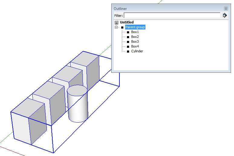

                  So you want to get a child group out of a parent group? Have you tried opening the parent group and using Edit>Cut to remove it? Then close the parent group and choose either Edit>Paste or Edit>Paste in place to put the child group out on its own.
                  Parent group before extracting cylinder
                  After opening the group, cutting the cylinder, and then pasting in place outside of the group
                  You could also just select the child group in Outliner and drag it out of the parent group.
