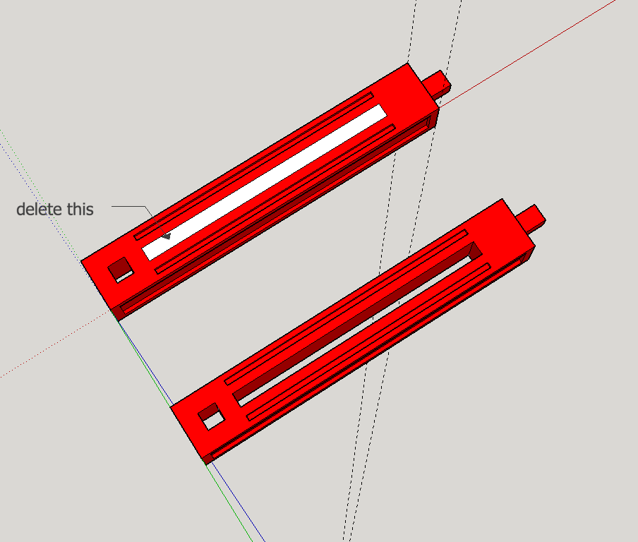

      Hello everyone,
      I have a design attached, I put a rectangular hole in it and can see through the object, then when I go to the other side its white and I cant see through?
      Thanks
      DF
      Brick.skp
      • cottyC
        cotty
        You don't see through the model, you only see the backside of the white face on the other side. Delete the face and the hole will be complete.
        (It's not a good idea to post your email address here, everyone can anser here in the topic or with a private message (pm), I've deleted it)
        my SketchUp gallery
        • D
          dermotfox
          what is the face?
          How do I delete it?
          DF
          • S
            slbaumgartner
            Click on the indicated face then press delete

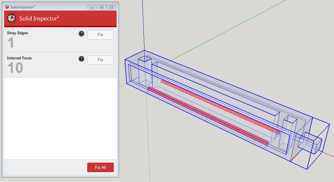

              Can someone have a look at the attachment and tell me if all is ok for printing.
              Thanks
              Brick.skp
                At this point it isn't a solid.
                After choosing Fix All in Solid Inspector², it becomes a solid and should print just fine.
