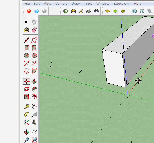

            This is what it could look like if you have a section plane .

              Guys, thank you very much, yes hidden section planes !! duh.
