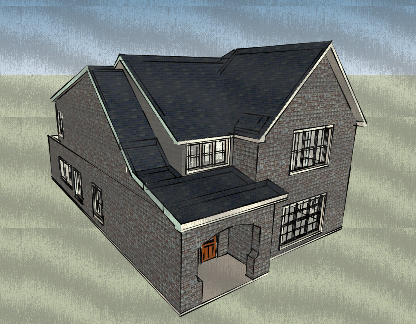

      Hi Everyone,
      I need a little help. As you can see in the attached file I have hidden lines showing up. These come from actual geometry that is below the roof line. I've tried everything I know of to get rid of them from shift erasing the lines to raising the roof line. It's like my roof is invisible and we are seeing through the roof to the edges beneath the shingles. I also have the issue of the line between the 1st and second floors.
      Lines and geometry seen through roof
      Any wisdom in removing these would be greatly appreciated.

        Edges Bleeding Through Geometry | SketchUcation
        Sometimes you can see edges bleeding through geometry in SketchUp. In this tutorial, we explore the reasons and try to find solutions or workarounds for the problem.
        (sketchucation.com)
        It's a common problem
          Do you have section cuts with faces at various locations through the model? If so, turn off the layers for the section cuts so they don't show. That'll probably get rid of those vertical light lines as well, which are probably unpainted faces in the section cuts.
