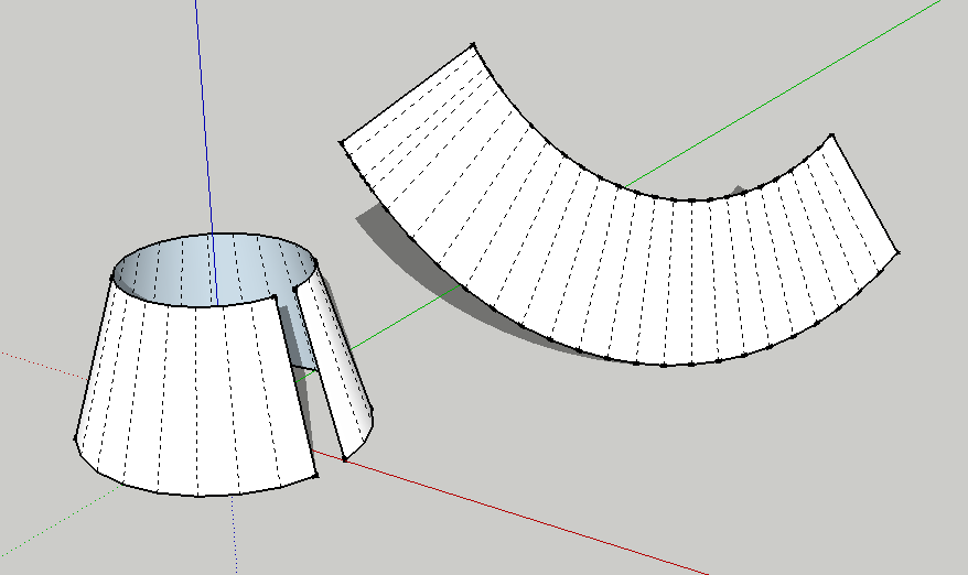

        Did you install the latest version of Flattery available from the SketchUcation Plugin Store ?
        I updated it to work in ALL versions including v2014.
        http://sketchucation.com/pluginstore?pln=Flattery
        The one on the tool's own website is NOT compatible with the latest SketchUp.
        Install the RBZ using Preferences > Extensions > Install... button or the PluginStore dialog's AutoInstall option...
        It works fine for me...
        Index the edges, then click on each face in turn...
        The flattened form is made just fine. πŸ˜„

              You will notice that my example shows the individual facets that form the surface of the code [dotted-lines].
              To see them use View > Hidden Geometry > ON
              Then pick each adjacent facet in turn...
              When you are picking the 'surface' you are not necessarily clicking on the relevant facet...
              πŸ€“
