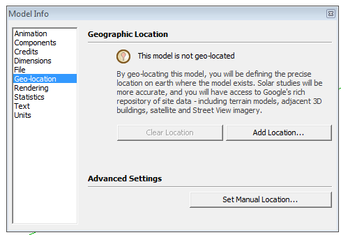

        It sounds to me as if your components are geo-located. Maybe your template is set up with geo-location?
        Check to see under Window>Preferences>Geo-Location. Remove the geo-location if needed.

          Without seeing your components here's a guess. πŸ€“
          Your custom components' SKP files are 'geo-located'.
          This means they'll insert at the origin without any choice to place them.
          To fix it edit the SKP files and remove the 'geo-location' in Model Info...
          Now they'll insert as you had hoped...
          If your Template is geo-located remove that feature and re-save as the Template so it stops happening.
          Only geo-locate SKP files that have buildings/sites in them, so that they themselves are indeed geo-located.
          A piece of furniture etc should never needs to be geo-located ???

            yes, that was the problem!
            Thanks to both of you.
