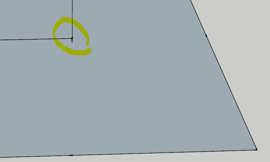

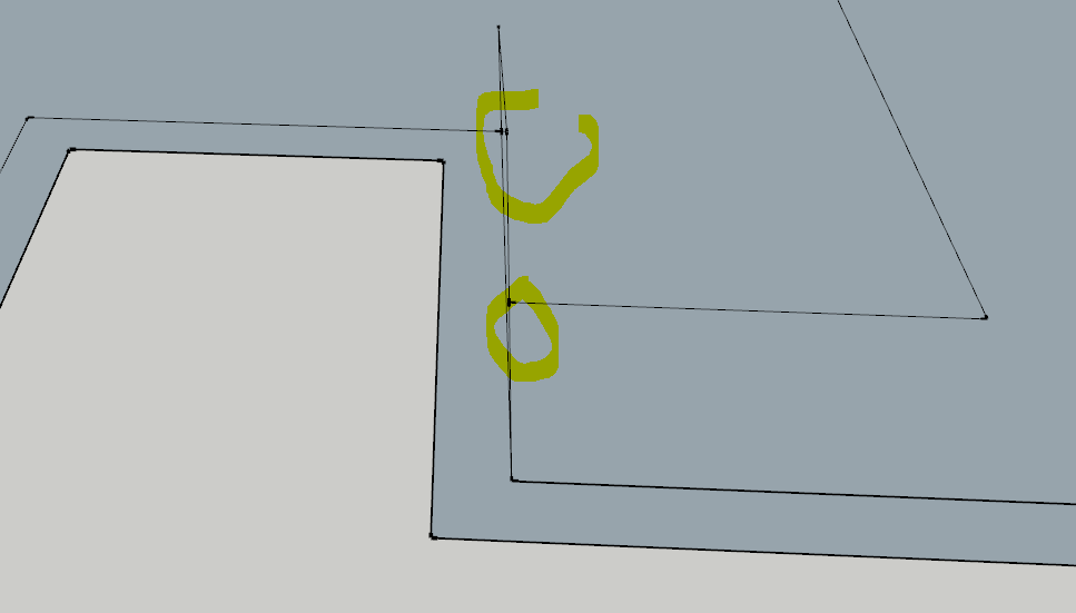

        The reason you can't PushPull is that you need a face to do that to... you SKP only has a few faces, it's mostly lines...
        Also when you paint you have no faces to receive the material...
        I drew an enormous circle centered on the plan and selected all, then used the context-menu 'Intersect' a few times...
        Most of the edges then took faces.
        I erased the unneeded outer circle...
        BUT if you set your Style's edges to show profiles thicker, with end-points, but no 'extensions' you can see some lines are still 'unfaced'.
        See 0...
        Some of these lines - like single line room dividers - are to be expected, but others look like they ought to 'face' BUT if you zoom in closely you'll see that sloppily drawn lines are not orthogonal and form thin wedges etc - see 1 & 2...
