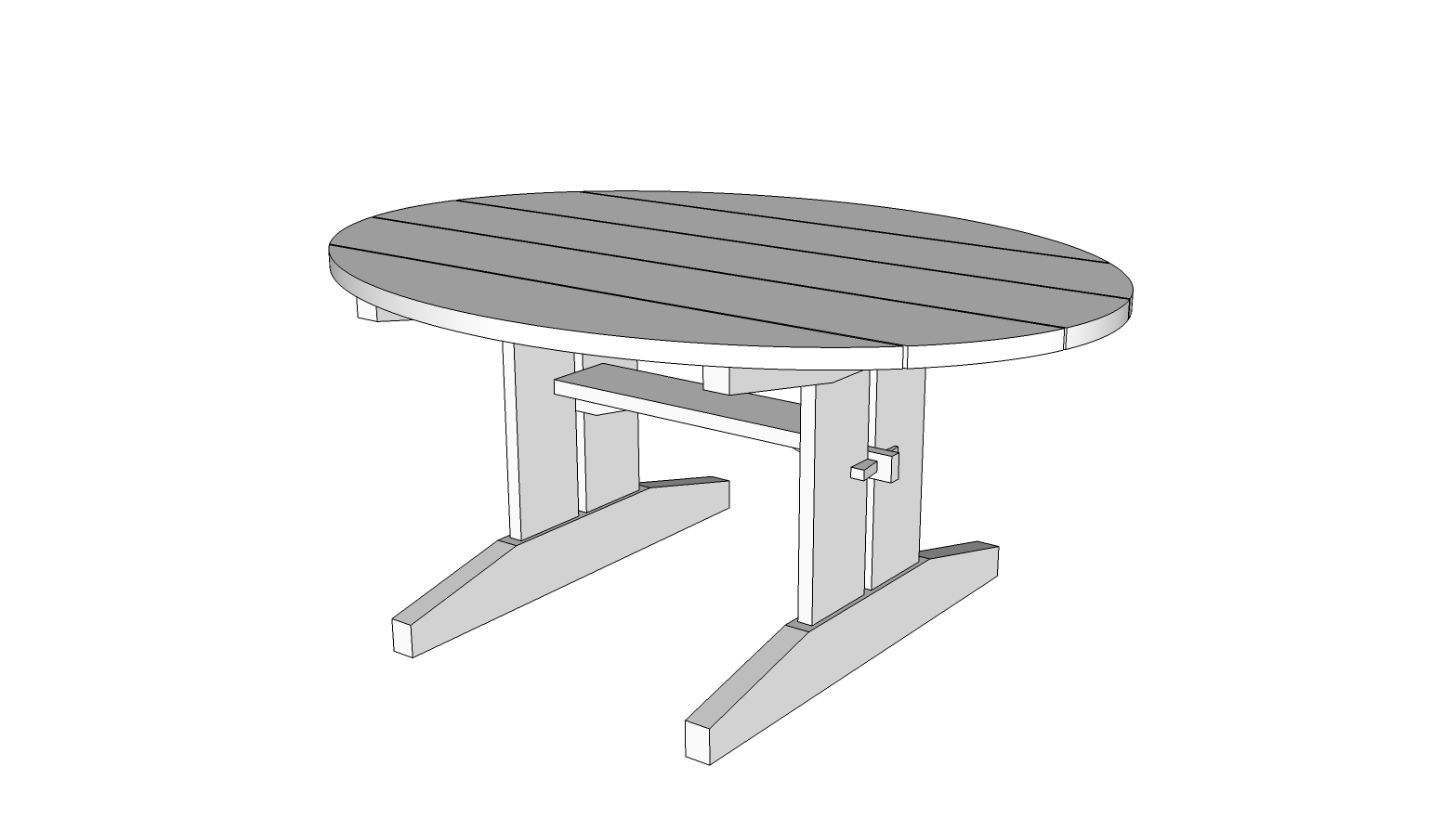

          I've had another poke through the rest of your model and cleaned it up so it should make a nice cut list. You could compare the outliner in your copy of the file to this one.
          I fixed the issue with the braces by deleting one and replacing it with a copy of the other. I also corrected the reversed faces on the table top planks and, because the two outside and two second planks are identical, I replaced planks 4 and 5 with copies of planks 1 and 2.
          I didn't change any dimensions but you might want to do so on the legs anyway.

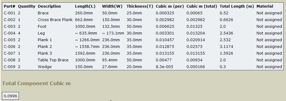

          By the way, I have plugs set up to fall into the Parts section of the cut list so they don't show with the lumber.
