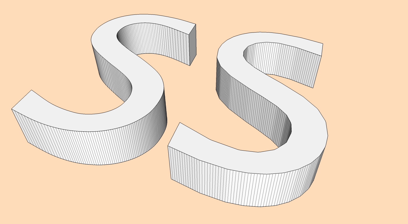

      • GaieusG Offline
        You can do this with the circle, arc and polygon entities because they are recognized as such entities (and handled differently from "normal" geometry) but these 3D letters are just simple geometry without special, added functions.
        So the only way is to either draw the 2D geometry in another application (which has the ability to do it with more segments), import the geometry and start from there or subdivide the 3D geometry inside SU. Below is a model with two S letters - the left one is the default S and the right one is a subdivided S. Certainly some more care could have been given to the subdivision (especially at the ends of the letter) but the theory works.
        1 iteration with Artisan - the top and bottom faces were creased (to keep them planar) and at the end, CleanUp used to remove unnecessary, coplanar edges from these faces.
