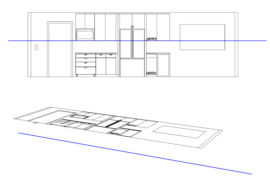

      It looks as if you drew that line on the xy plane, because that is where Sketchup draws by default. But the rest of the stuff is floating at z=? units above the xy plane. If you want it to be on the xy plane, I suggest that you select the kitchen drawing and make it a group or component to isolate it from other stuff and then move it down. To ensure that it lands on the xy, draw a large rectangle, for instance, on xy and move the grouped kitchen down until it rests on the rectangle. You can delete the rectangle if you wish.
      If you mean to stand the kitchen up parallel to the xz plane, then you will need to rotate the grouped kitchen on its local axis. You can do this with the Move tool with groups by orbiting near one end of the drawing selecting the group, and pressing the M key or using the Move Icon and then finding the little cross points on the edge. Move becomes Rotate when you hover over these cross points.

      Okay. Thanks. I think the apparent take-home message here is that I NEVER KNEW until now that I could inadvertently draw an image that would be floating, not anchored to the default axes. I think that's what you're telling me. At least, that's what I'm going to try: moving it to an axis intersection. Thanks much for your time.
      Yes. That took care of it. Ask me if I feel stuuuuuupid!

      Here we go (uploaded image). In the top half of the uploaded pic I have drawn a line across the kitchen wall. Let's pretend that I intend to leave the line and erase everything under it. The image would now show only the top third of the fridge, the microwave, so forth. But, by using the orbit tool, I can see that the line is not really on the kitchen image. It's actually below it. Therefore the existing image was on one plane and the new line is on another plane. When I drew the line I was in "top" view if that helps.
