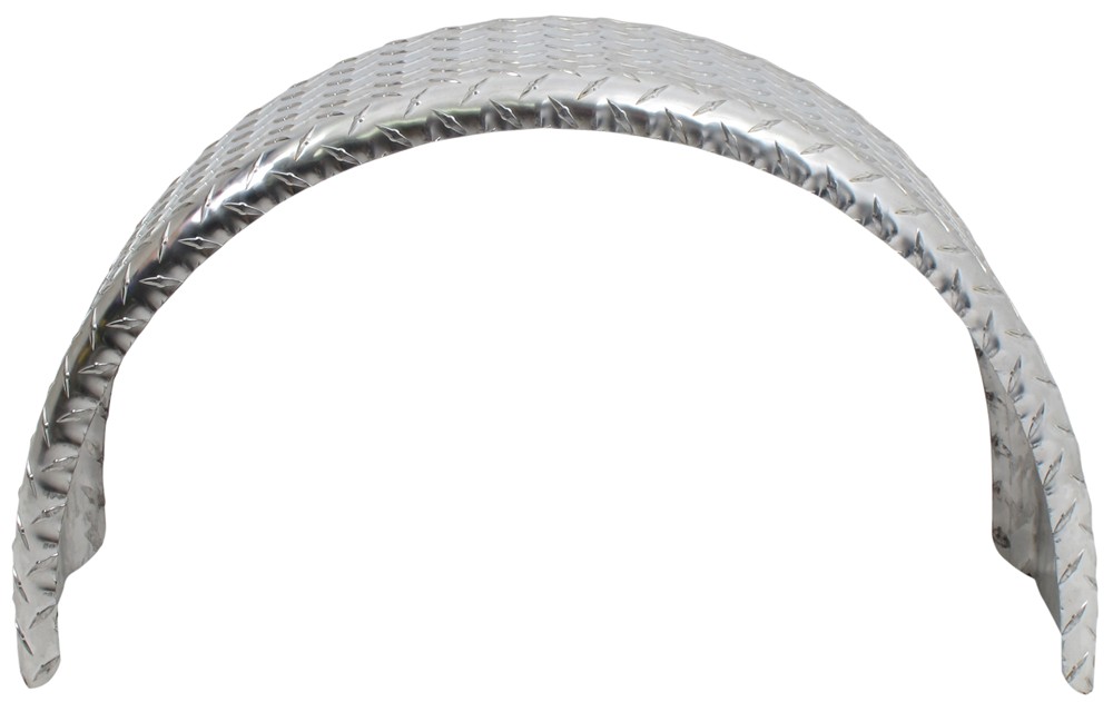

                  but when i meet something more complicated, a smart plugin would be handy 😄
                  http://i52.tinypic.com/zujcp1.jpg
                  http://ak.buy.com/PI/0/500/235458632.jpg
                  http://www.etrailer.com/merchant2/graphics/00000001/pics/C/E/CE17960ATB_2_1000.jpg
                  SU 2015 Pro on Win10 x64
                    That's a little more of a challenge. For that mug I think I would use Shape Bender. On the other hand, is there a good reason for using 3D geometry for drawing the mug over using a material?
