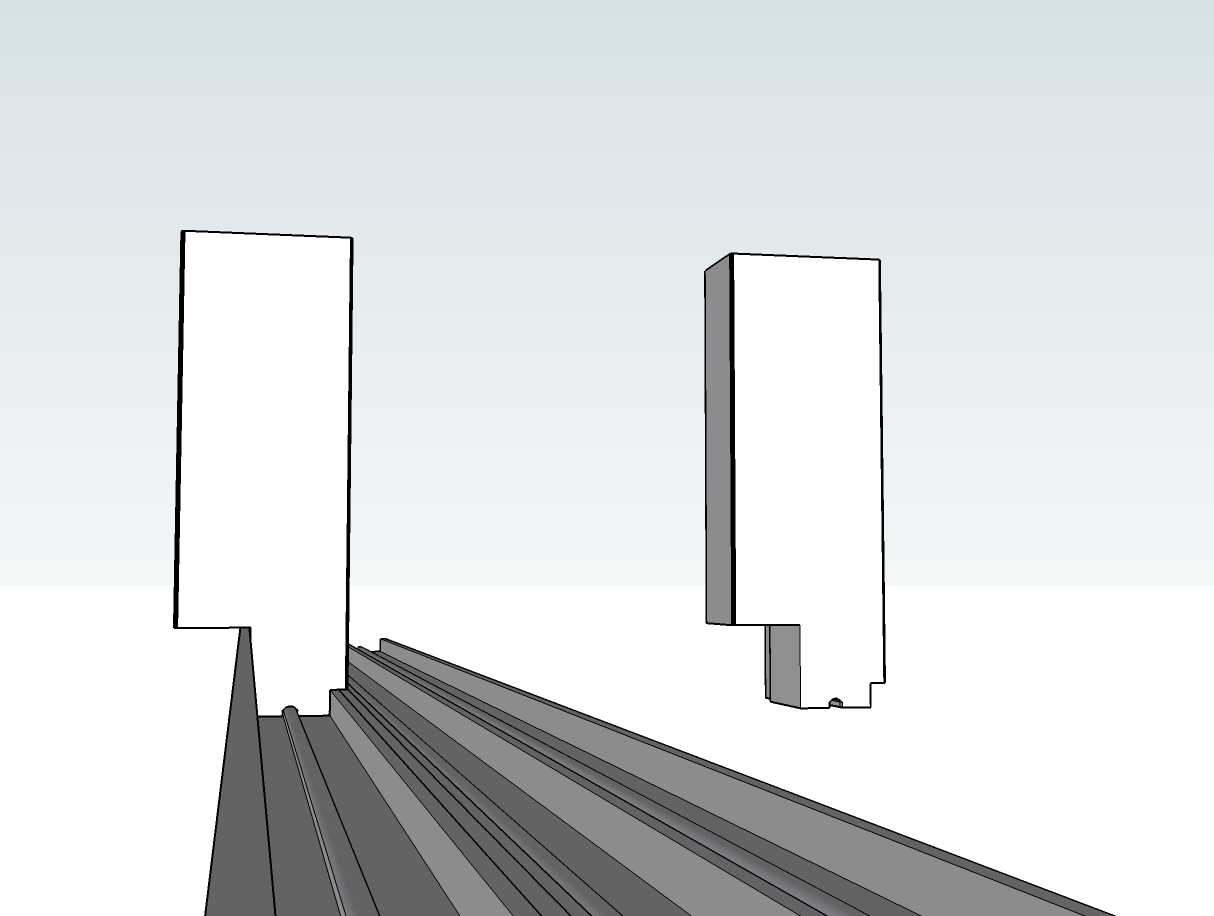

      Hi, my name is Kyle, and I am a drafter for a sliding door company. I am trying to make details for our warehouse using GS8 (not pro) of our notches and cannot seem to make them on the solid. I have downloaded the solid editor ruby plugin, but it won't recognize my parts as solids enough to edit them. Maybe there is a different plugin? Perhaps it's even simpler than I am making it. Please help!I have attached the file so you may see what I'm working with and what I'm trying to accomplish.

            Actually, I misunderstood. We usually have a stiffener inside this and I didn't realize it wasn't in there. I was able to resolve those issues and make the notches accordingly. I don't know why it was eluding me for so long. However, this was very time consuming and not efficient at all. I am hoping for a better way to do this besides learning to program the ruby console myself. Any suggestions. Here is the drawing with the notches.

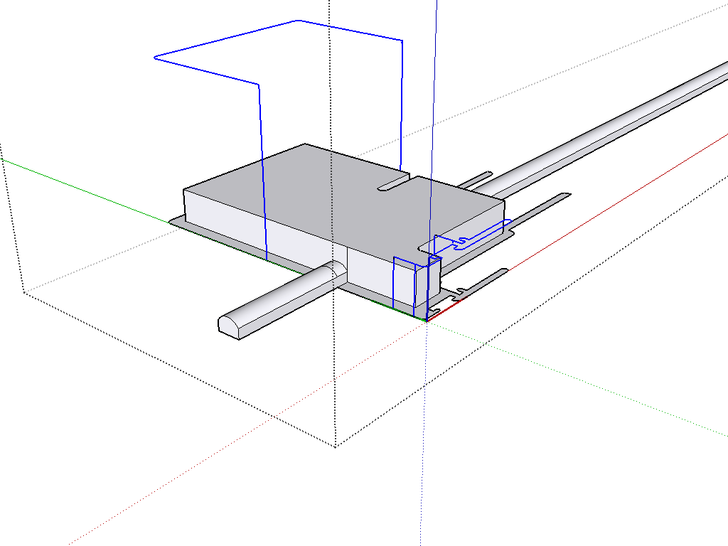

              Here're a couple of things to think about that might help. First, despite aiming for what is termed a "solid" group or component, the 3D shapes you create are not really solid. You must have faces to enclose the shape. Think about the cutter you would use to cut a real block in one pass and draw that shape and extrude it through the block. Select the block and the extruded shape, intersect them and delete the unneeded geometry. Since your pieces with the notches have to fit the track or whatever it is, you can use a copy of the track as the cutter for the block. You can't use the track itself because you need to leave behind the part of the "cutter" in the block.
              So here's one approach in the SKP file.
              1. The track.
              2. the un-notched block siting on the track.
              3. I opened the track component for editing and selected the faces that contact the block. I copied (Ctrl+C) those faces, closed the track component and opened the block component for editing. Then I hit Edit>Paste in Place. There's a copy of the block in the background showing the results of that.
              4. I selected all the geometry in the block component, right clicked on it and chose Intersect Faces>With Selection. Then I deleted the waste bits of the track surface. In the background you can see the block with the outline of the notches.
              5. Finally I deleted the waste on the block leaving the notches.
              Now for a simple block like I drew, you could just use Push/Pull on the waste side of the profile but the method I showed would also work on more complex shapes as well.
