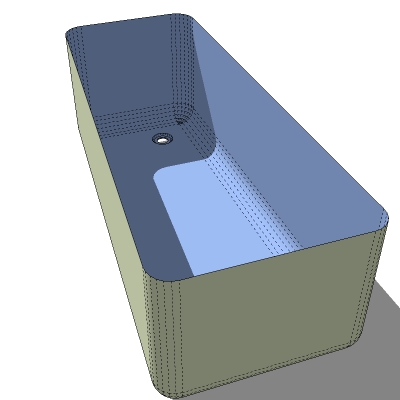

        I'm not sure exactly what you are trying to achieve. If it's something like this, then it can be achieved very easily with the Round Corners in 3D plugin. This shows a cuboid with vertical sides and a base that tapers from the 'head' to the 'foot' of the bath.
        The settings were a radius of 3" for the corners with 6 segments to the curve. You'll need to select the base plus the 4 vertical edges at the corners. If you select the actual side faces, the plugin will round to top corners too. In case it's not clear, you start wih a coffin-shaped cuboid with no round edges at all. The plugin does it all.bathtub_thumb.jpg

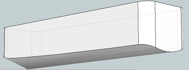

        If I've got it wrong and the base actually tapers in a kind of inverse pyramid towards the drain, then the same plugin will result in something like the second image. You may have to do an Intersect (with itself) and a clean up to remove unwanted flanges produced by a mismatch between the surfaces available and what radius you have specified for the rounded corners.

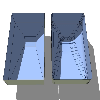

          Thank you for your reply! I need something that is closer to your second attempt, but whereas your base is comprised of "flat" 2D rectangular faces which slant in the vertical dimension towards the "foot" of the bath (albeit rounded around their intersection with eachother/the vertical faces), I was after a base that is tapered like a funnel...
          You can see here my attempt so far, but where the intersection between the base and vertical edges remains "sharp" / not rounded. I tried using your Round Corners plugin, but it doesn't seem to handle the funnel base face very well.

                Well, with the round corner plugin, this is where I could get - but me also a bit of eye balling (and comparing your inner circle's size this way). Note that to avoid overkilling it, I used a 6 segmented rounding only.
                With curved edges, the plugin is never perfect either so here and there some manual correction is often needed.
