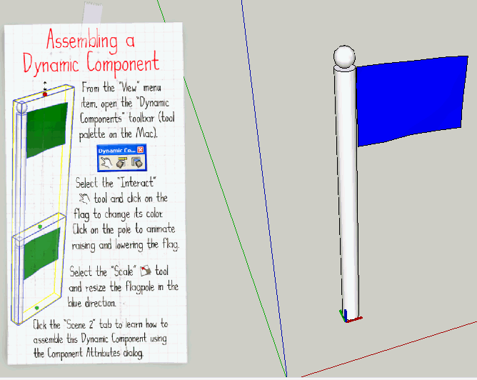

              Would something like this work?
              http://farm8.staticflickr.com/7181/6980761437_ff4849fb08_z.jpg
              Text is screen text inserted in SketchUp. Actually the Postit note paper was made in SketchUp, too. This was done using the image of the note as a watermark as TIG suggested. The downside to this is that to make the screen text display on the "note", the watermark has to be set as a background image. If the model covers that part of the screen, it'll mask the note. If the watermark was a foreground image, it would cover the screen text.
