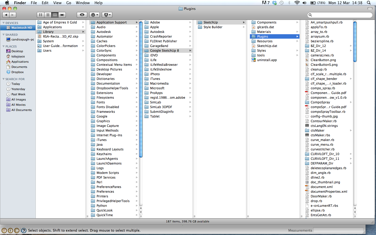

                  The file is the same, but the location is different. There is loads of threads with the same question.
                  Put the .rb files in Mac HD - Library - App Support - Google Sketch Up 8 - Sketch Up - Plugins
                  Or unzip the files in here to.
