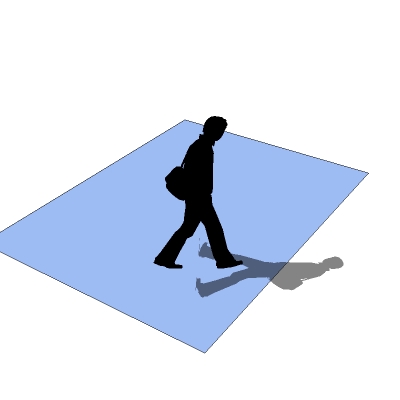

          I get funny misplaced shadows for components: SU v8.0M2:
          EDIT: OK.. the component is set to "Always face camera" so it's rotating, but the shadow cast is not updated.
          The shadow fix has no effect.

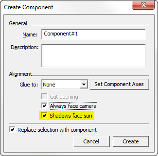

              Yup you're correct.
              Why on earth, did Google make that option always checked by default ?
              I'm not here much anymore.
              • thomthomT Offline
                thomthom
                Because most probably want it? A face-me is usually 2D and the shadows would just disappear in certain angles.
                • Alan FraserA Offline
                  Alan Fraser
                  I agree with Dan; I'd much rather it was unchecked by default. It's far more preferable to see a gradually thinning shadow than one that periodically jumps and loses all contact with the object that's supposed to be casting it. This just looks weird.
