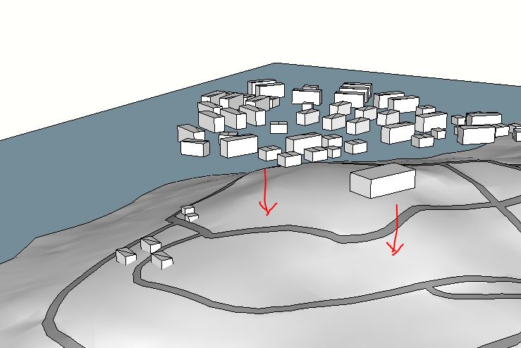

      Hi all,
      Wondering if you guys could help me out, I'm not sure if there's a script or technique I can use to achieve this.
      I have a series of components in the same plane (horizontal) which need to be moved on the blue axis until they touch a surface below.
      Is there a quick way of doing this or do I need to pick up each component, snap to blue axis and drag it down until it hits the plane.
      I've uploaded an image which should illustrate this...
      Thanks,
      Stu
      • TIGT Offline
        You think you need 'Drop' http://www.smustard.com/find/
        Simply select the things and 'drop'... they stop at the first surface hit, or z=0
        • S Offline
          stuartcuss
          Thanks for the speedy reply TIG, that worked a treat. Saves me a lot of time πŸ˜„
