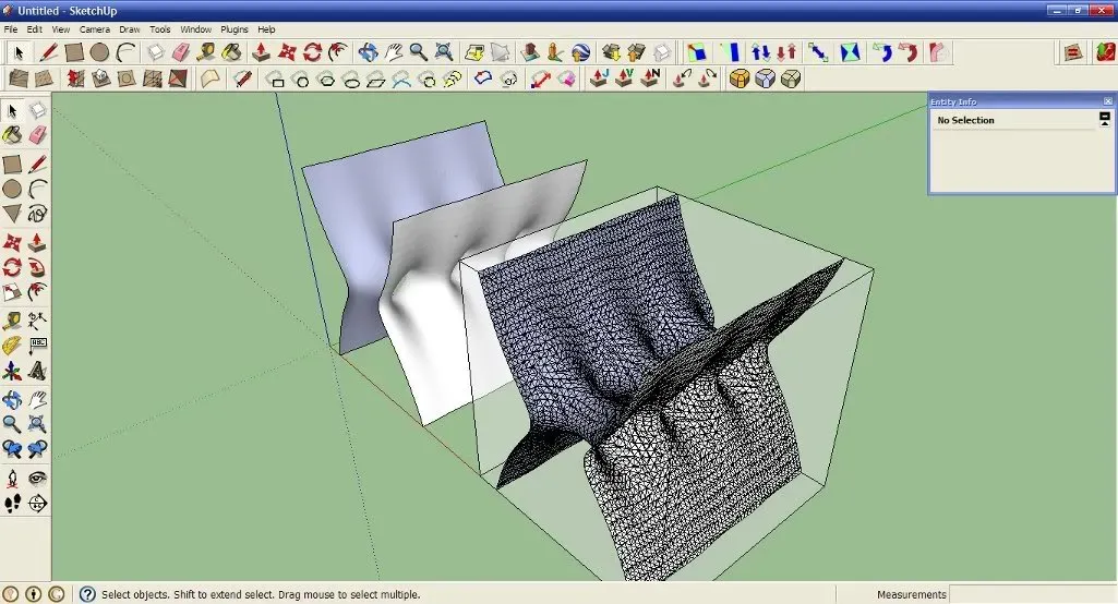

      SurfaceGen is a plugin which allows you to create surfaces from mathematical formulae. There are two modes supported:
      Function Mode
      The Z coordinates of points in a heightmap are specified as a function of X and Y. There can therefore only be one Z value per X, Y coordinate.
      Equation Mode
      An equation relating X, Y and Z is given. This mode can graph any 3D surface for which there is a formula, but may take slightly longer. The marching cubes algorithm (wow that one is a pain to implement!) is used to generate a surface around a 3D grid of data generated from the equation.
      Instructions
      • Select the SurfaceGen tool from its toolbar.
      • Click to set one corner of the graph.
      • Click again to set the opposite corner on the same level.
      • Click a third time to set the height of the graph.
      • You can transform the resulting group without causing problems.
      • After creating the graph and it becoming selected, the SurfaceGen Options window should appear.
      • Set the axis ranges, the SurfaceGen mode and enter an equation.
      • Choose if you want to show the graph boundary. This will make a semi-transparent box around the graph. The sides facing the camera will always be invisible as you rotate the camera allowing you to see the surface.
      • Choose if you want the graph to be smooth.
      • Click generate. This may take a few seconds, so be patient. It will happen asynchronously, so you should still be able to move the camera around.
      • You can set the surface material by using the paint bucket on the group. The surface will become the selected material.
      • Opening the group will cause the graph to turn into a normal group. The plugin will ask if you really want to do this before it actually happens.

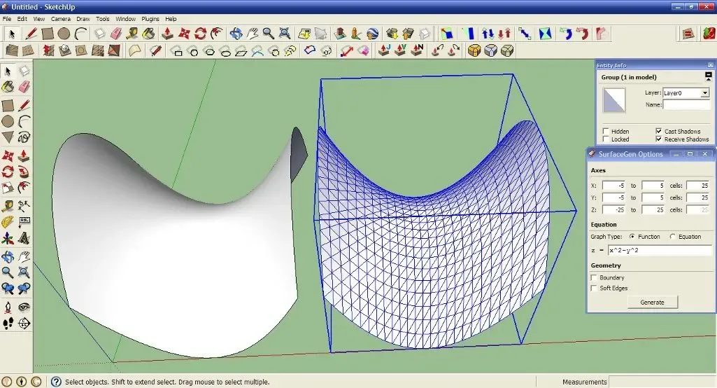

          Here is a little test I did, using the settings shown in the screenshot.
          Did I say thank you, Diggsey? 😄

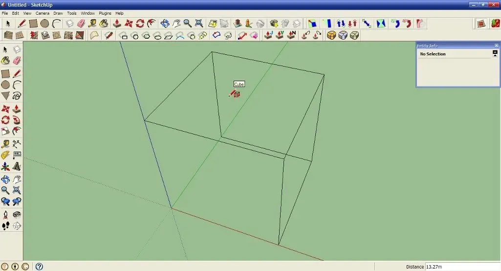

                                          In the V6
                                          We can draw the "Box" but dialog's window don't opening 😉
                                          No error message, nothing in the Ruby console

                                            @Pilou
                                            Just re-select the group with the select tool. It seems that the SelectionObserver doesn't fire when the selection is changed in code.
