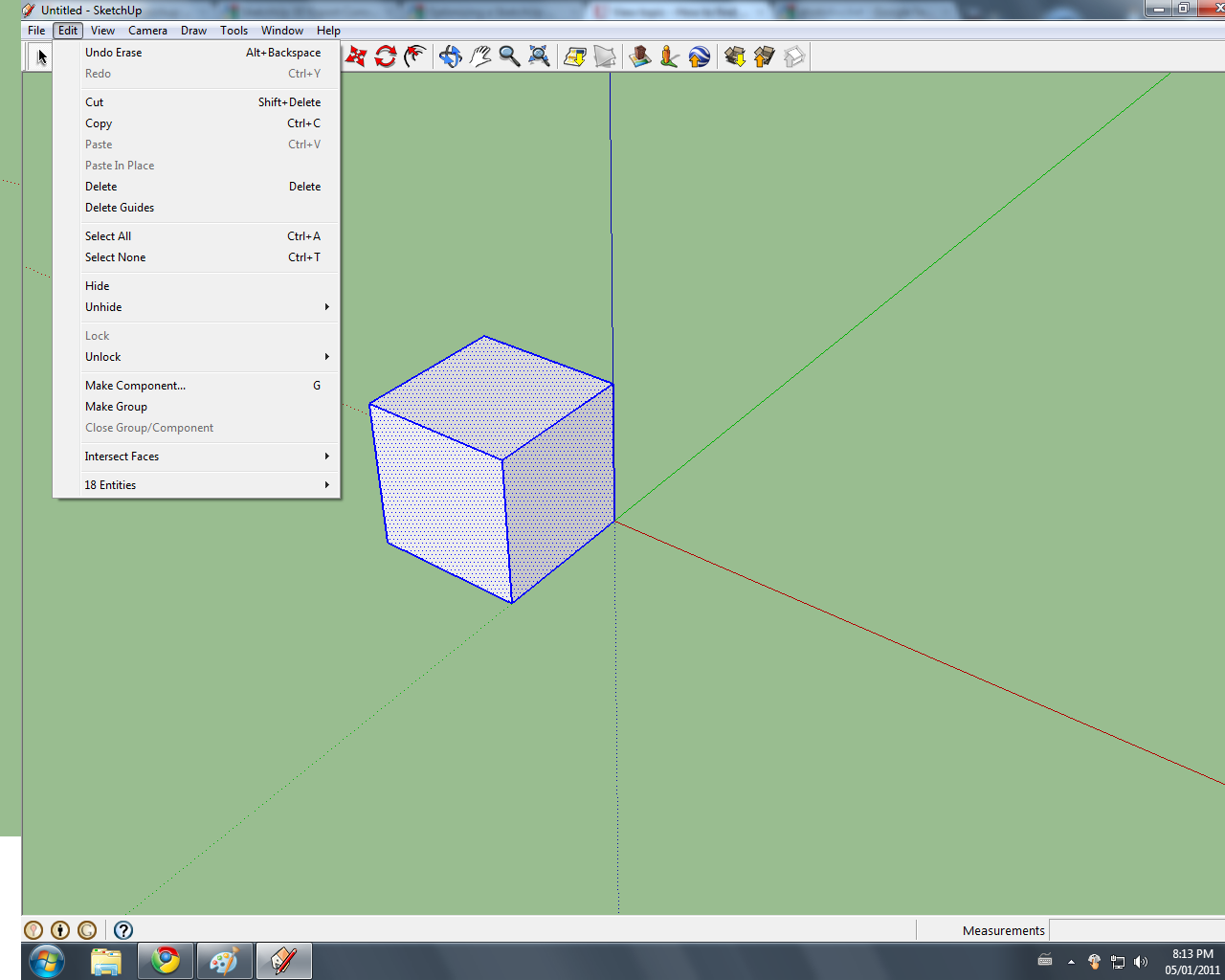

      I tried my first serious SketchUp model on this new computer, and I very quickly ran into lag. I was encouraged to find my graphic card type and install all the latest drivers (which I did) but the help it offered was marginal. So now I'm wondering if the model I was doing simply had too many polygons, but I realize I don't even know how SketchUp counts it's polygons.
      I did find this thing which counts "entities": http://i215.photobucket.com/albums/cc42/Edward_Wolf/Entities.png
      And as my model increases in complexity the number of entities does increase. The cube has 6 sides though... and 18 entities... does this mean the entities include all surfaces and all edges? Anyway, my super Torus started making my computer cough blood at around 16000 entities, is that really that many? I have a dual core processor running at 2.8 GHz, 3 GB DDR3 RAM, and an Nvidia GeForce 9200 graphics unit. You'd think it would be able to handle a decent amount. What is the typical limits for polygons (or entities) for your average user?

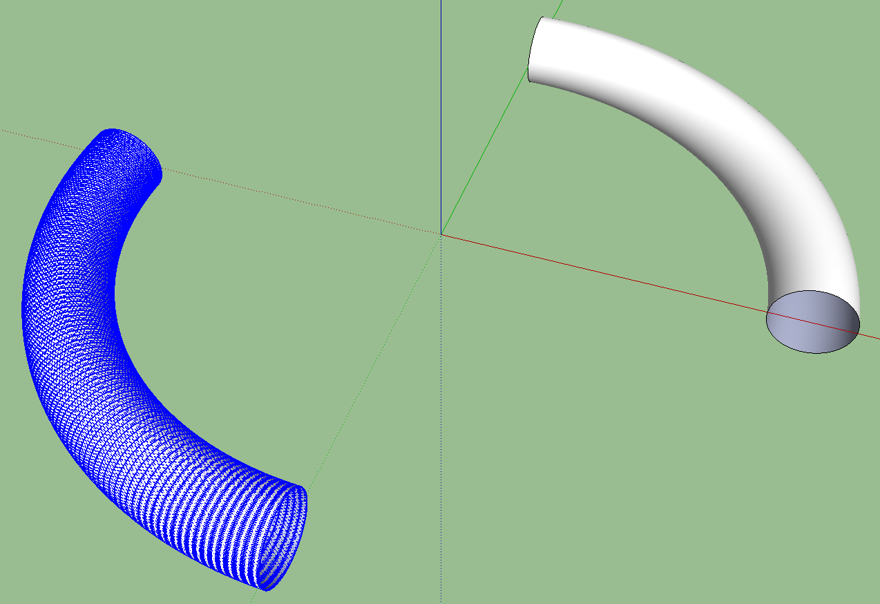

      This is the super Torus that gave me so much grief, I didn't even get to finish it!
      http://i215.photobucket.com/albums/cc42/Edward_Wolf/Refference/Step06.png
