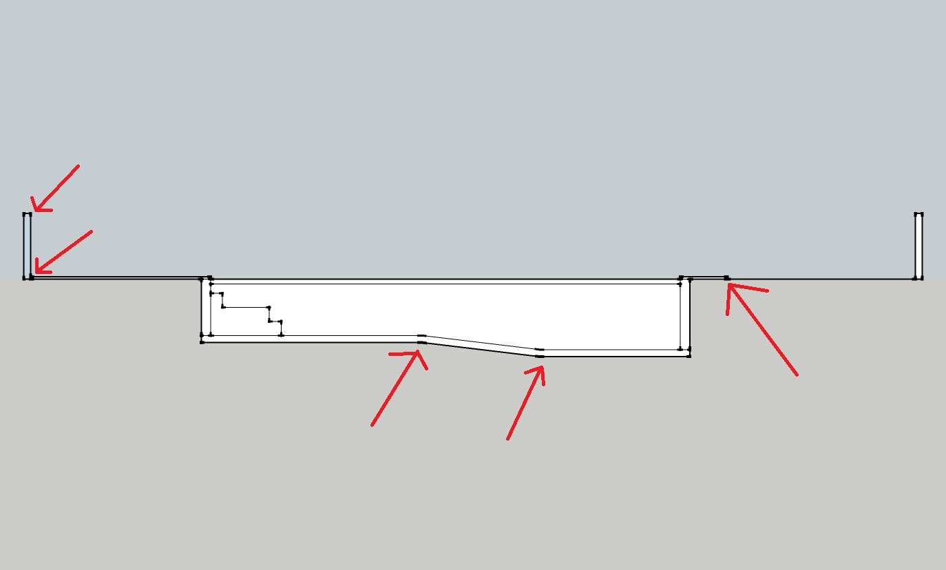

      Could you tell me how to hide "point" beetween 2 line ? (cf join photo)I thinks it's on sketchup menu but i don't found where ....
      I don't have the problem on previous project but only since the last update and last project (the beginning of my swimming pool.)
      I hope you understand my problem not really important but i found this very ugly

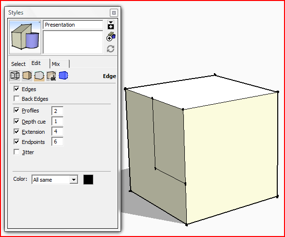

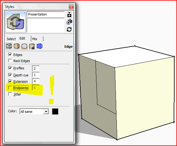

        You need to either change your Style Settings or use another Style that doesn't display 'Endpoints' - see these two examples...Capture.PNGCapture1.PNG
        • Rich O BrienR Online
          Hi,
          Go to 'Window > Styles'
          In the 'Styles' dialog box select the 'Edit' tab
          In the 'Edit' tab uncheck 'Endpoints'
          Now your endpoints should no longer display. You can also select different style type in this dialogue box and create your own.
