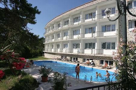

                                Yet another one by Forbát. This was eventually built although not by his design but very similarly. The image is what it looks today, not my render... 😒
                                http://www.szallashelyajanlo.hu/szallas/406_1.jpg
                                and the design by Forbát:
