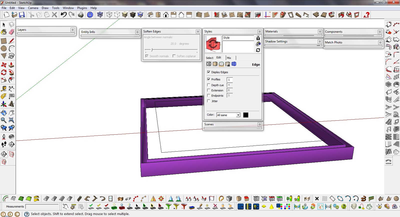

      Hi all,
      Has anyone had this before; when iI do a 'follow me', all the edges of the profile are not drawn. See attached.
      Thanks for a great forum.

          Hi TIG,
          Thanks for the response. Not quite sure what you mean when you say 'different relationship'. I've tried putting the profile inside & outside the path, but I'm still getting the same results. ( changed the profile a bit to suit final gutter design).

            Maybe your path is not correct or the profile is not touching it correctly.
            See this SU file for ideas.
            follow me.skp

              Thanks Jean,
              Still touch & go, but seems to be working now. I had to experiment with placing the profile on different points along the path to get a perfect 'followme'.
