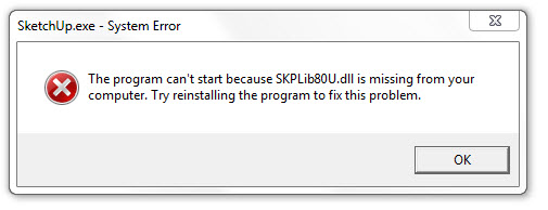

              can someone tell me what this is now? got it since i've been screwing around so much. did a reinstall/repair but didn't help.

                The file c:\windows\SKPLib80U.dll is only referred once on the net within a Trojan test...
                It might be a SP lib ?
                Don't know what it is at all ?
                When do you get the error - when starting SUp ??

                  yes the error was starting SU but i went into preferences and re-enabled all the plugins and it went away. πŸ˜„
