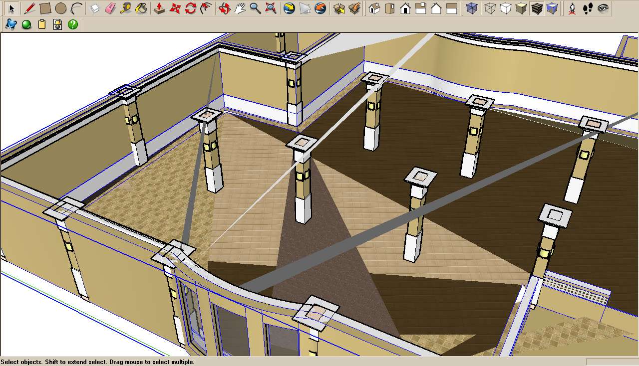

      I'm relatively new to Sketchup. I've encountered this problem before, but I always just put the thought aside.

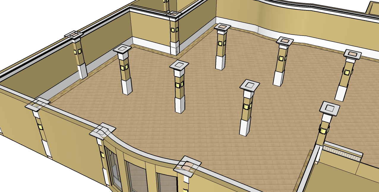

      Here's the problem. I normally import plans from Autocad into Sketchup. The problem is, sometimes, when I start creating it in 3d, some kind of surface noise appears. When I'm in the working program, the noise is there. But when i export it, it's gone. How do I remedy this problem?
      My settings: Macbook 13" bootcamp with Windows XP. I use sketchup in XP. The version I use is the free version of Sketchup 6 and I use Autocad 2008.
      Thanks,
      demet
      This is a screen capture of the problem.
      This is the same model exported into JPEG.

                WOW! Thanks Gai! I exploded one of the groups and the noise was gone. Thanks. However, some surfaces are still noisy, but not as annoying. I don't know how to turn off the graphics acceleration on the XP side of my Mac though.
