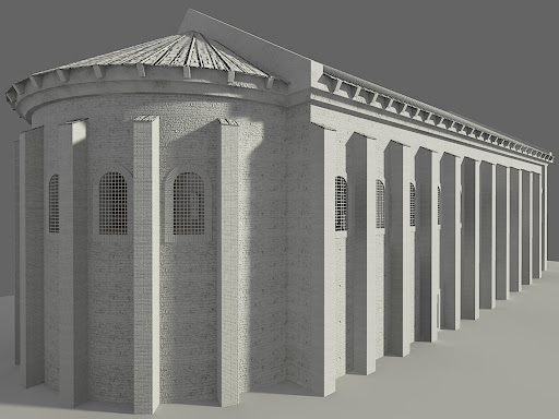

      I am thinking of doing some clay renders of a model I am currently working on, and I would like to know which settings in SU ( sun, shadow, background, etc ) will affect the render. Are there any recommended ones? I am trying out Kerkythea and Twilight Render.

        Only shadows (and camera settings). Both in Twilight and Kerky, you can control the warmth of your simple SU front face with the sun shine colour (give it a very subtle yellow). Then either use a spherical background or rather a simple (say mid- or light grey) background colour. See some examples among my Basilica WIP's here:
        http://picasaweb.google.com/csaba.pozsarko/Bazilika#
        However if you have already applied bump maps to your model, they will also affect the render - like in this image:
        http://lh3.ggpht.com/_zcvsIuYiVbo/SvQNPtQMFpI/AAAAAAAACyk/Fs4hB3OkSrU/Bazilika-Clay17.jpg

          Thanks, dude!
          I am going to give this a try.
          BTW great work! Where is that?

              NTh - it's in PΓ©cs, my place. Of course, we could only find the foundations.
