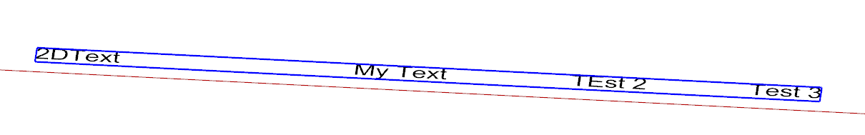

                With my current version of the 2D Tools, if I try to create 2D Text, it always add "2D Text" far to the left of the text I entered. The only way I can modify it is to post the text, right click on it, got to the drop-down tool bar and then edit the text.
                Am I doing something wrong or is the way the current version of the tool works?
                Press F1...thank me later

                    Just wanted to give you an idea of what I am getting with I use the tool.
                    Also, Here is what I read in the Help documentation
                    Here is an example where I tried to edit the text twice. I have not been able to delete the "added" text and blank spaces.

                      To edit any existing 2D Text string in its modal input dialog you can single-click to select within the string [in the dialog], OR double-click on part of it [in the dialog], OR treble-click on it to select all of it [in the dialog] - that should then include all of the string including any spaces.
                      When you have what you want to change highlighted you can press the delete key to clear it or simply type in new text to overwrite it...
                      You type in new text as desired and then OK to go the the next step of placing it - OR if you have chosen to edit settings as second dialog opens before placement.
                      Initially new 2D Text always starts with '2D Text' in the dialog, followed by some spaces to ensure the box is a reasonable width.
                      This text-string should be selected as the dialog opens, so you typing new text should replace it, but if you click in it you are editing the string, as explained above.
                      Any subsequent 2D Text you make during that session defaults to the last used string, as do any other settings you have used.
                      If you select a piece of existing 2d Text, then there is an item in the context-menu 'Edit 2D Text'
                      This opens a modal input dialog where you can edit the text string - all as outlined above - and/or choose to alter other settings if you wish, in which case a second settings dialog opens, much like when you make new 2D Text, except that in that one the Alignment setting is not available to change...
