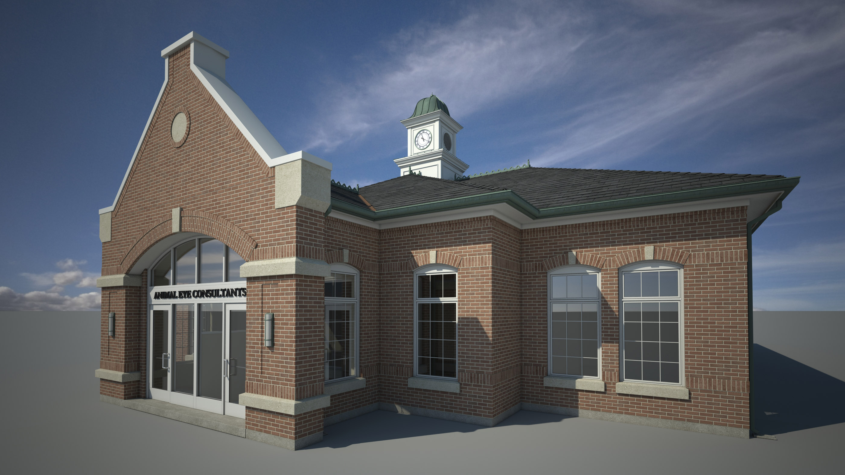

                              Hey SU'ers,
                              First off, Thomas, thank you so much for all the amazing plugins you've made and all the hard work you've done for the SU community! It's been quite a long time since I've been active on these forums, so I haven't had a chance to tell you. Big thanks! πŸ‘
                              Anyhow, I just started using this plugin the other day on a new project that has lots of curved brick headers and details and your plugins has worked amazing well!! I normally have to build a custom texture for each arch in photoshop. So this was really a time saver! Was also able to use it to speed up the roof texturing.
                              Here's a couple images from this project...
                              http://www.thepixelartist.com/c2005007/p2011011/20110807/p2011011-20110805-img08.jpg
                              http://www.thepixelartist.com/c2005007/p2011011/20110807/p2011011-20110805-img07.jpg

                              • thomthomT
                                thomthom
                                Thanks for posting examples of what you used the plugin for. It's very nice to see what results people get from it. πŸ˜„
                                Glad you managed to work out your problem. I'm sure Fredo will offer an option for you.
