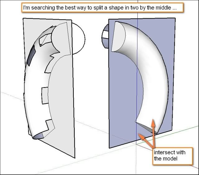

      It seems to be so an evidence for lot of you that i havn't found the way to do it anywhere:
      "How do we split a complexe shape by the middle"??
      http://i274.photobucket.com/albums/jj245/Spendauballet/SketchUp/splitn2-1.jpg
      ](http://i274.photobucket.com/albums/jj245/Spendauballet/SketchUp/splitn2.jpg)
      For now, i make a parallel rectangular face ,-, move the shape by is center to surface ,-, Select all, intersect with model ,-, delete an half part. >> laborious, long, many wrong erased pieces. I'm shure we can do it better

        If there is a better way I don't know it. One way to ease the post-intersect selecting is to switch to Parallel Projection, but with a complex model it can still be tedious to get just the geometry you want to keep or erase.

          See attached SU file for ideas.

            Simple and clever. 😄

              Sometimes I find myself working at the unusual angle and with a complex overlapping geometry. This does not always allows me to switch my view in a way where i can select one half. Espatially if i am not cutting by a simple single face.
              So here is my method
              one half group_ag.skp

                Good,, very Good,, Excellent i would say.
                I think we've got all we needed.. Thanks SCF folks

                  The tip about grouping after the intersect is very useful for the more complicated shapes.
