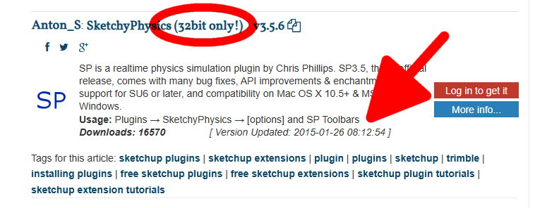

              Can anyone help me out? i have multiple versions of su, but in each one the same error message pops up the second i open skutchup. I cant get to any of the tools, its like its not installed, but i have uninstalled and reinstalled it multipule times and nothing seems to work. Any help would be appreciated, thanks.
              • S
                SketchyPhysicsNutt
                Hi firedrake this might help u along all your multiple versions of su need to be 32bit only
                and in profile i noticed your a mac user try d/l SketchyPhysics 3.7.3 version a lot bugs have been fixed
                How to install:
                Mac: /Library/Application Support/Google Sketchup #/Sketchup/plugins
                (On a Mac, make sure that the contents of the SketchyPhysics folder you got out of the downloaded zip are in the Plugins folder itself, NOT in a SketchyPhysics folder within the Plugins folder.)
                hope it helps
