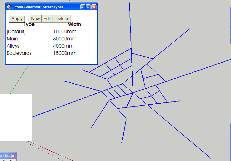

          • utilerU
            utiler
            Thanks Thomas!! Neat little tool.... 👍
            One thing: When you 'Define Types', the New / Edit / Delete functions do not seem to provide any options. [see attached]
            Questions:
            1. How does color get assigned to street types?
            2. The resulting road system creates an interpolating line which is hidden. Is there a way to be able to create the face as a whole so if you need to pushpull you only need to select on face...?
            An idea:
            1. Is there a way to include merging lanes such as acceleration and deceleration lanes? Maybe byway of color....? Break a line where the lane widens to two and color differently.....
            Anyhow, thanks for helping out getting it loaded. 🎉 I've been asked to collaborate on an Urban Renewal Proposal so I hope to give this a try for it!
            Cheers,
            StreetGen-Dialogue.swf
