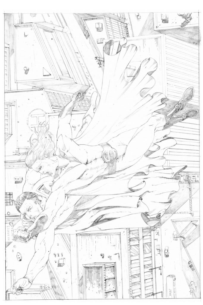

    • RE: Using Sketchup for comic book illustration...
      http://img.photobucket.com/albums/v477/Comixjunky/Superman_Sentry_Cover_01small.jpg
      First work done with Slicer.
      posted in Newbie Forum
