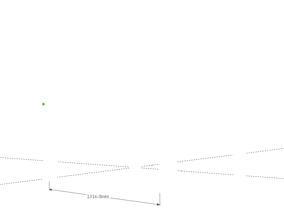

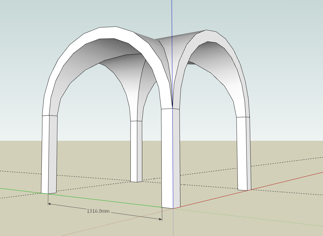

      geertdobbels
    • RE: Sketchup raster image edges not visible
      Hi Dave,
      Thanks for the reply, however, I don't think it has to do with the line size. Edges not visible means no edges at all, neither small nor long ones.
      As an example one of the sketchup tutorials in default style :
      My default style
      using my default style
      Skechy crayon style
      using the sketchy crayon style
      I added the dimension to show that it seems only to happen with raster img. edges.
      Geert
      posted in Newbie Forum

      geertdobbels
    • Sketchup raster image edges not visible
      Hi,
      When I change styles, there are a lot of styles where no edges appear at all. I have the impression that this is always the case when the edges are represented by raster imagas (for example, in none of the sketchy styles) the edges show up on my screen.
      I hope this subject does not exist yet on this forum, but being new to the forum, I could not find a way to do a search on the topics.....
      by the way, I am running sketchup 8 through WINE on a linux machine.....
      Geert
