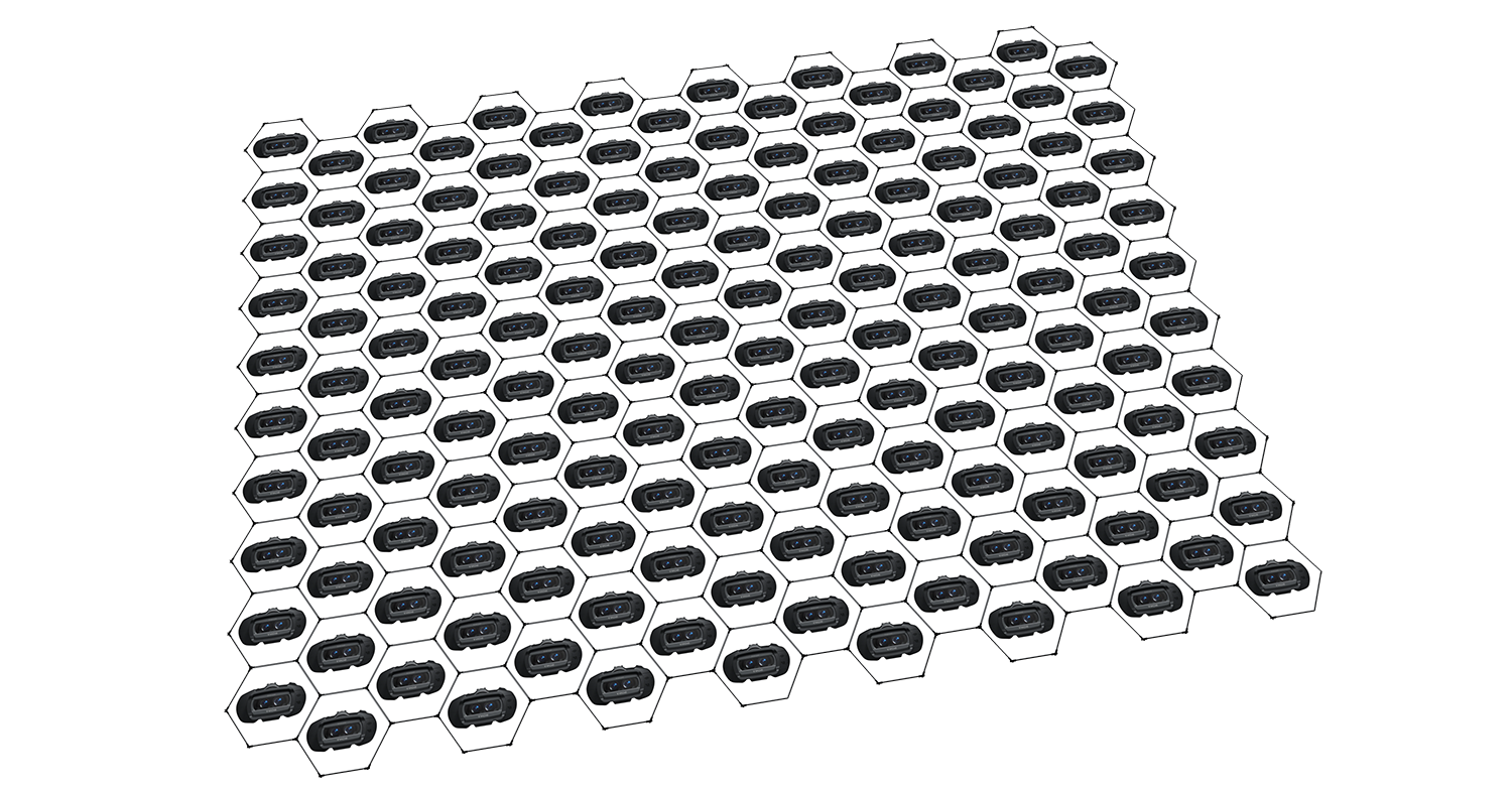

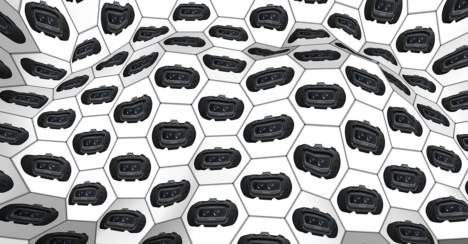

      Hi Garry,
      I am attaching:
      • an example of the flat hexagon pattern (the textures here are repeated whereas the final version should have a different product photo in each hexagon)
      • a rough version of what the final 3D textured hexagon mesh result is intended to look like (once again, the final result should have different product shots in each of the hexagons)
      So basically the problem I am trying to tackle is having to manually apply and adjust a texture for each of those hexagons, which would take many hours.
      I am of course open to any suggestions to alternative methods of achieving a similar result.
      Thanks,
      Boris
      Textured Hexagon Pattern

      Hi Guys,
      First post here - glad to join the community!
      In my latest Sketchup project, I am building a textured honeycomb (hexagon pattern) mesh. The idea is to make a hexagon pattern on a plane, apply different textures to each of the hexagons that comprise it, and then warp the whole thing into a cool 'topographical'-style shape.
      To use as the textures, I have created an array of identically-shaped, hexagonal PNG images (using transparency). The problem is that applying the textures one by one to the hexagon surfaces and having to adjust each one to fit the surface correctly will be incredibly time consuming, considering there are going to be 100+ surfaces.
      Do you guys have any ideas on how I can apply the textures in a quicker manner, at least not having to manually adjust each image on each hexagon?
      Thanks for you help!
