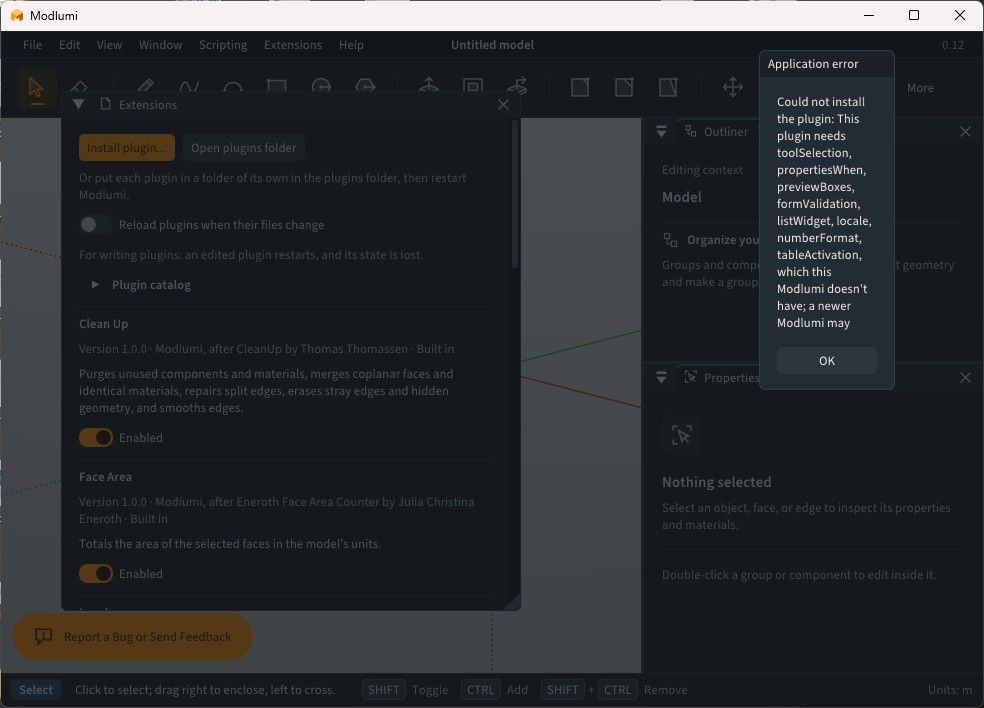

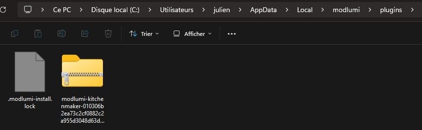

              I downloaded the zip file and first placed it on my desktop, then went to modlumi/extensions/install a plugin/; I selected the zip file and got an error.
              So, I moved the zip file to the user/local/modlumi/plugins folder and tried again, but got another error message.
              Krass
              • KrassK
                Krass
                Krass
                • pixelcruncherP
                  @krass You need to upgrade to v0.15. Your build is out of date.

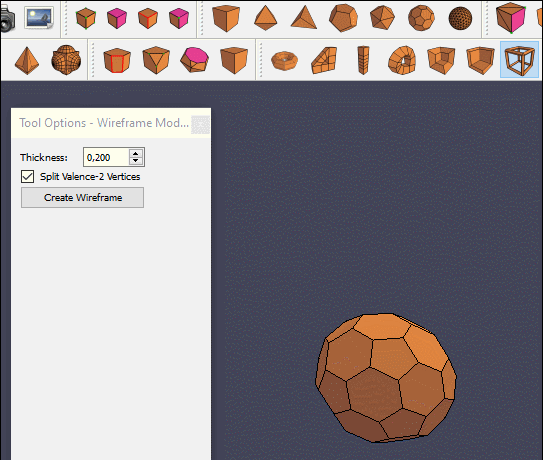

                          Cool we can Drag & Drop files! πŸ™‚

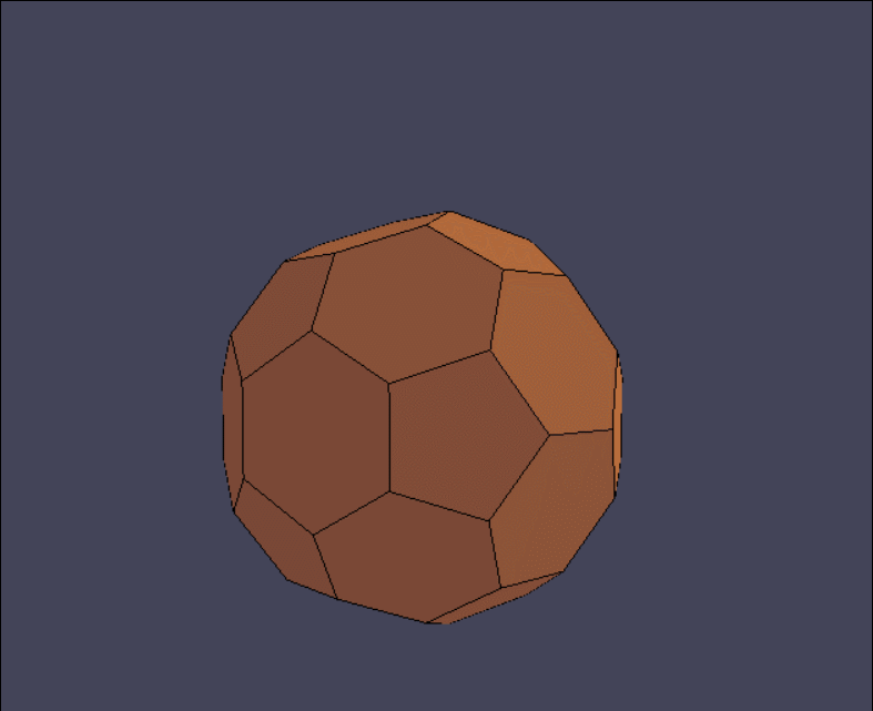

                          In TopMod for ModLumi you must make "Save As" OBJ and not Export OBJ!
                          Import OBJ from TopMod Inside ModLumi works fine! πŸ™‚ (faces are triangulated but less than Stl)
                          soccerball.zip the TopMod obj file!
                            From TopMod to Modlumi you can Export STL (no other choise) πŸ™‚
                            STL also ... but faces are more triangulated!
                            soccerballst.zip the STL TopMod File!

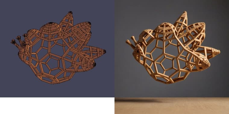

                              TopMod --> ModLumi --> free Gemini

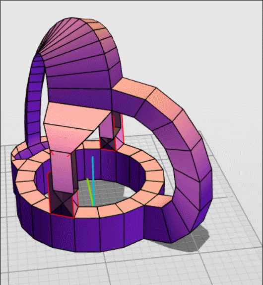

                                        • Try Rail Sweep, an experimental plugin that sweeps between two profiles along two rails (desktop only). The profile blends from the start shape to the end shape while the rails set each section's position, direction and width, with a live preview. Closed profiles make a solid. It's an experiment: it may change or be removed, and I'd like to hear how it works for you. Thanks @pilou for the idea! Source: https://github.com/thomasloockx/modlumi-plugins/tree/main/plugins/rail-sweep

                                            About the Sweep 2 rails : works like it must!
                                            Maybe give the possibility to have also only one Rail ?
                                            In any case very sufficient for speedy form in no time! πŸ™‚
