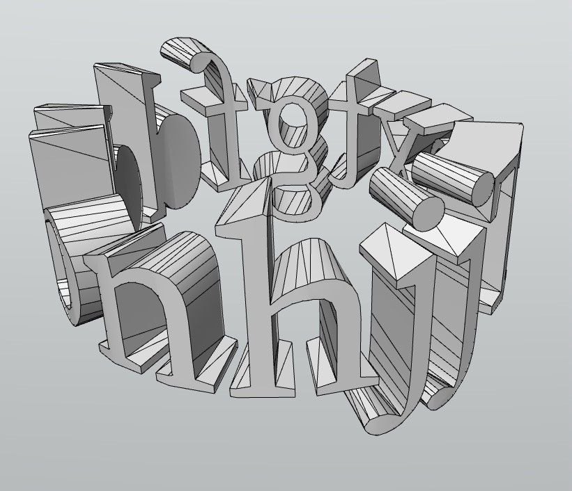

                            Excellent the 3D Text edition etc...
                            Here with the TRue Bend! πŸ˜‰

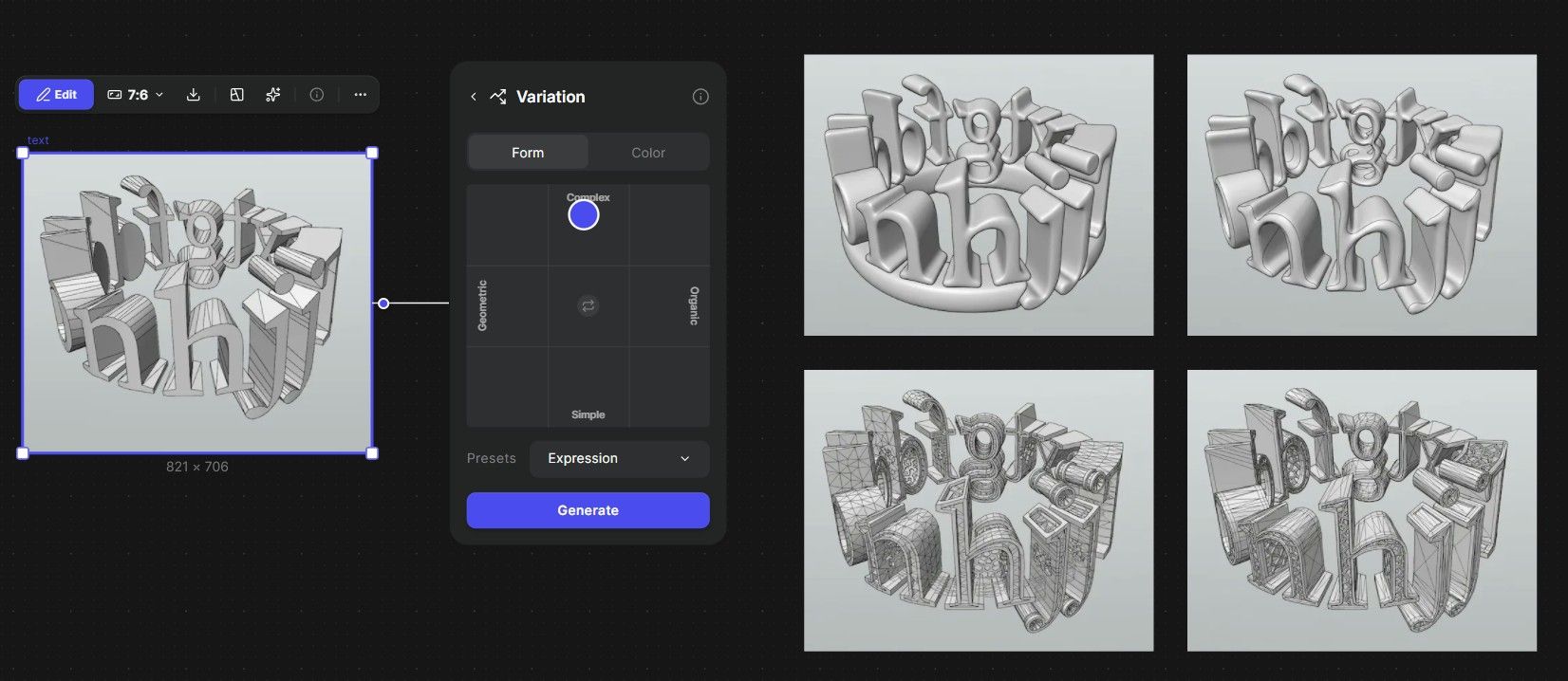

                            Then inside the free Vizcom (95% of functions are free) a killer one! πŸ˜‰
                            VIZCOM
                            Vizcom : IA GΓ©nΓ©raliste! Β  (Free / Pro)Β  Β  Β  800 crΓ©dits free /moisΒ  Β  Β  Β  Β  Β  Β  Β  Β  Β  Β  Libre adaptation de l' original
                            Moment Of Inspiration: Ze Zen Nurbs Modeleur ! (moiscript.weebly.com)

                              I have to ask: I understand creating the 3D text and using True end to shape but,
                              A. How did you pick the font?
                              B. How did you apply the materials the way you did (different colors for different letters and the wild/neat textures inside parts of the letters)?
                              BTW:. This is some really interesting results! πŸ‘πŸ‘
