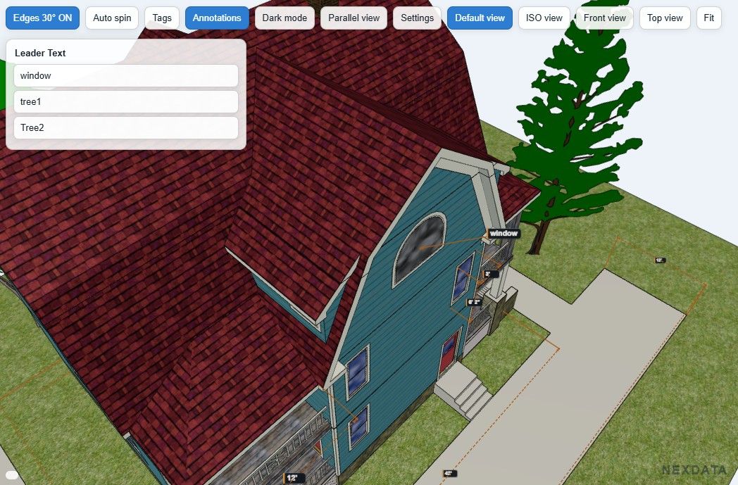

      I've been working on a small SketchUp extension for exporting a model as a single interactive HTML 3D file.
      The idea is simple: export the model, send the HTML file to someone, and they can open it directly in a web browser. No SketchUp, no viewer to install, no server and no Internet connection required.

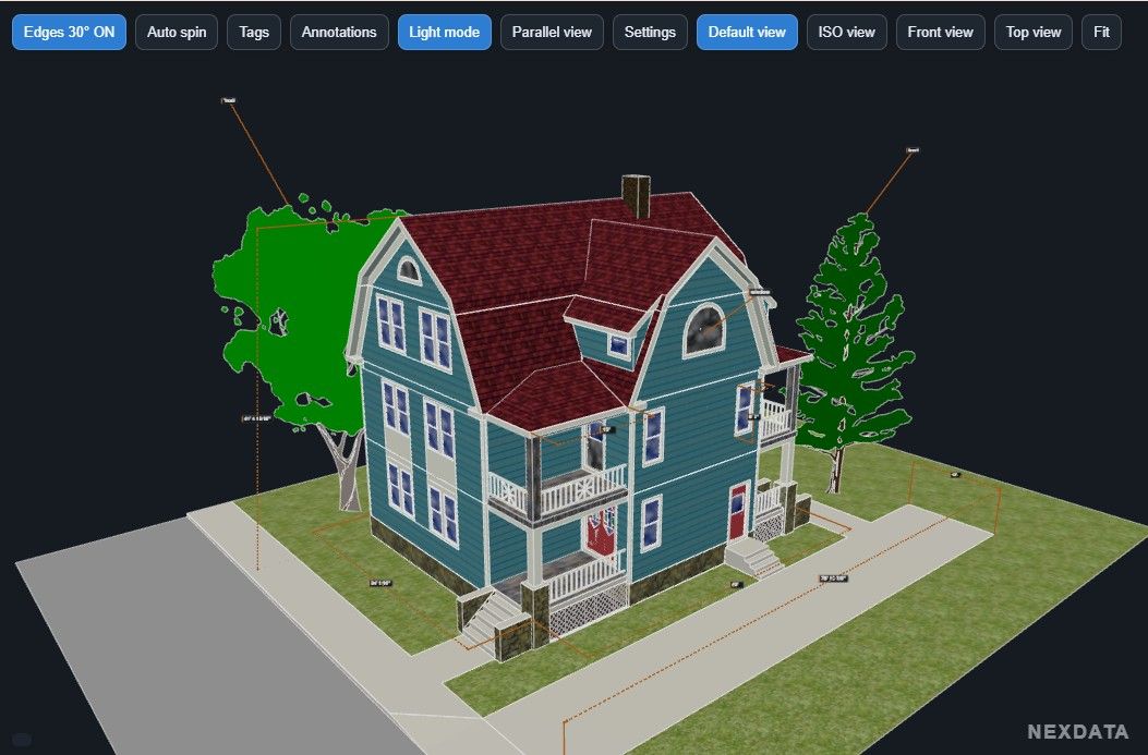

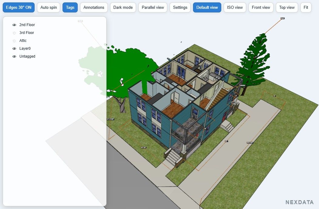

      The current version exports SketchUp materials and textures and includes a few tools in the HTML viewer: Tags with Visible / Transparent / Hidden states, Light/Dark mode, edges, standard views and parallel/perspective viewing.
      I've also added support for native SketchUp Dimensions and Leader Text. Leader Text annotations appear in an Annotations panel and clicking one takes you directly to that area of the model.
      An optional colored PLY point cloud can also be embedded in the same HTML file. This was particularly useful for my own work with scan data (like iPhone Lidar) and SketchUp models.
      Everything needed by the viewer, including Three.js, is embedded in the generated HTML, so the exported file is completely standalone and works offline.

          OK, I just went back and took a second look. I finally saw how to view the floor plans. Pretty neat once you figure it out. Might think about a little modification to make it a little easier but it is sure headed in the right direction.
          Yes, there are some bugs with a few lines showing up kind of randomly but again, this is going to be a hit IMO. Definitely keep up the development and/or clean up you model just a little for the demo.

              I tried the extension.
              The feature I miss is the possibility to export scenes from sketchup model.
              Perspective in Trimble connect seems to be better rendered than in a HTML file.
              Still, it is a functional extension that can be useful when don't have internet connection
              juan974J 1 Reply Last reply

                Thanks for testing it and for the feedback!
                The current version is actually a very small plugin, only a few KB, and it relies mainly on SketchUp’s native GLB exporter. So it naturally inherits some of its limitations, including scenes and some aspects of the rendering.
                I’m working on my own exporter to get more control over the model, scenes and rendering, but that’s a much bigger job and requires quite a bit more development.
                For now, the goal of this Free version is to keep it as simple and lightweight as possible.
