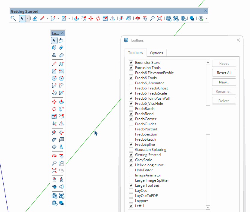

                  I hope you can see the proof here under that it IS possible to customize a toolbar with some tools from the Large Toolset (in the green circles)...

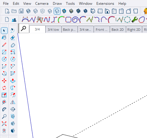

                        It doesn't matter if those native tools come from. It can be from those toolbars or their individual toolbars. They can be dragged to custom toolbars. For the last ten years I've been making three custom toolbars to replace native toolbars. The one at the top left under the menus and the two on the left. I leave out tools I have no need for such as Dimensions and the other text tools. This leaves more screen real estate for other tools.
