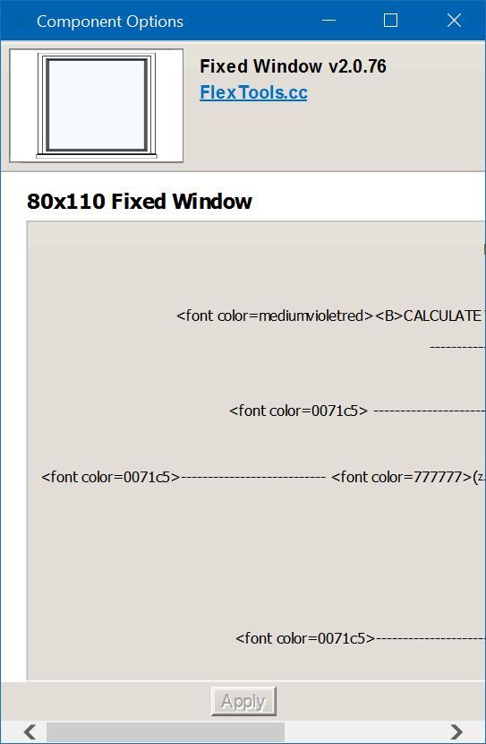

      Well, it's one of those Monday morning's again. This time I got an update from Sketchup for Dynamic Components and it broke the Flextools dynamic component window.
      See attached.
      I tested this in Sketchup 2022 and 2025.
      Help! I emailed Yoni about this.

        Yoni is pretty good to get back to customers.
        Loos like HTML rendering is messed up.

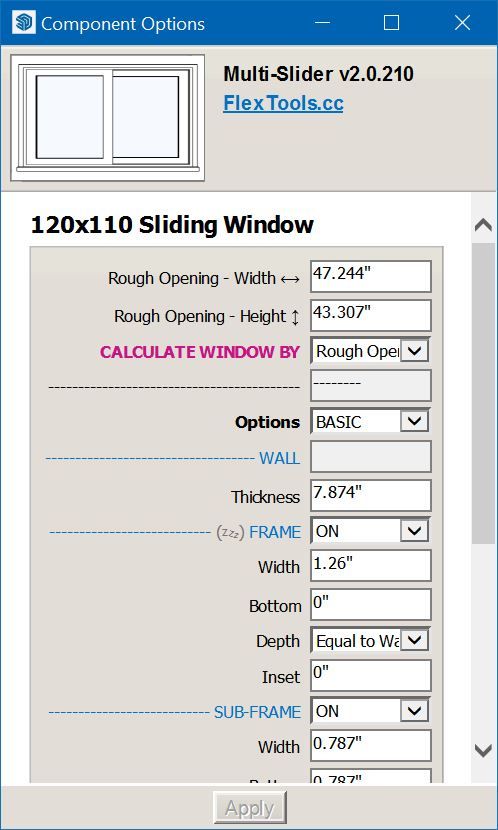

        • Gus RG
          Gus R @Rich O Brien
          @Rich-O-Brien Yep. So I went ahead and left the update in place but completely replaced the js directory and it's normal again. Yoni is already checking it out. Something is wrong with one of the js (Java script) files from Sketchup.
          Normal...
