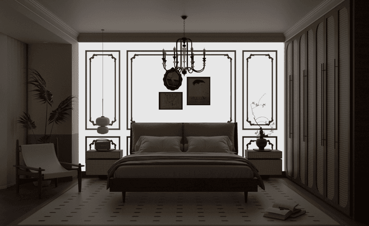

      I downloaded a scene for practice.
      Straight out of the box the back wall has an emissive quality I did not give it in Rayscaper or anywhere else.
      I know but you have to laugh. Checked settings in Rayscaper and everything is standard so hoo nose?

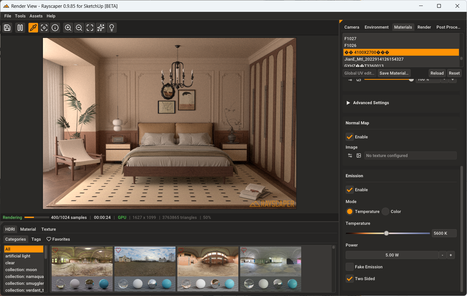

        Is this Rayscaper? What are the settings for that material?
          G'day, it is Rayscaper and the mat has no settings attached. Just a simple out of the box view.

              Is your environment just a plain white background? That would explain the back wall. Or rather that the back wall is missing and the environment is visible.

                The back wall is textures, you can see the texture on the wall on the left of the illuminated panel.
                No missing geometry.
                  Something is off with the back wall's scale.
                  But if you explode and regroup it fixes it.
                    Thanks Rich, just flat out did not think of that.
