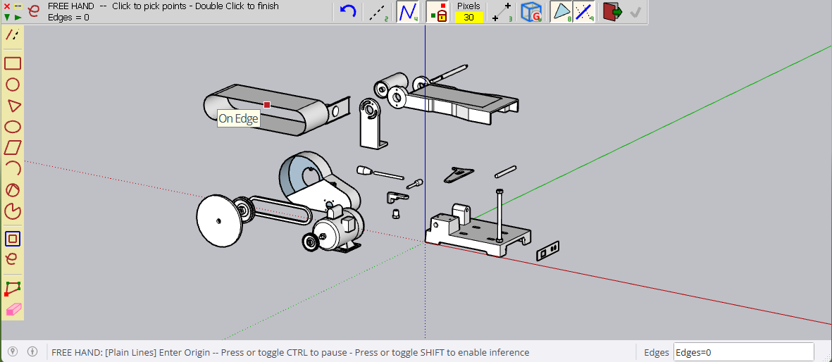

      I've been using the Fredo6 lib tools for a while now. This is the first time I've had any problems. Half of my menu options go blank when I open- Tools on a surface and I have no cursor to guide the placement of a point.
      I've updated all the tools for my Fredo Library. Reinstalled Fredo6Lib (just incase this was an issue) Restarted Sketchup and still having the issue.
      I work on a company computer so I'm waiting until last to reinstall SU25 as this will have to involve IT.
      With Draw on a surface the cursor shows up (On Edge)

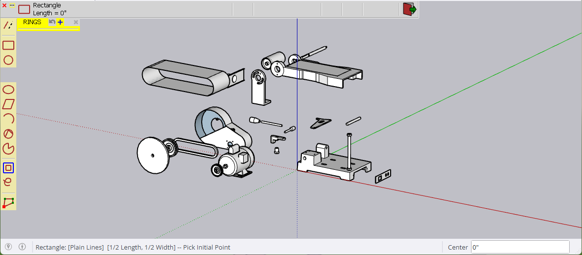

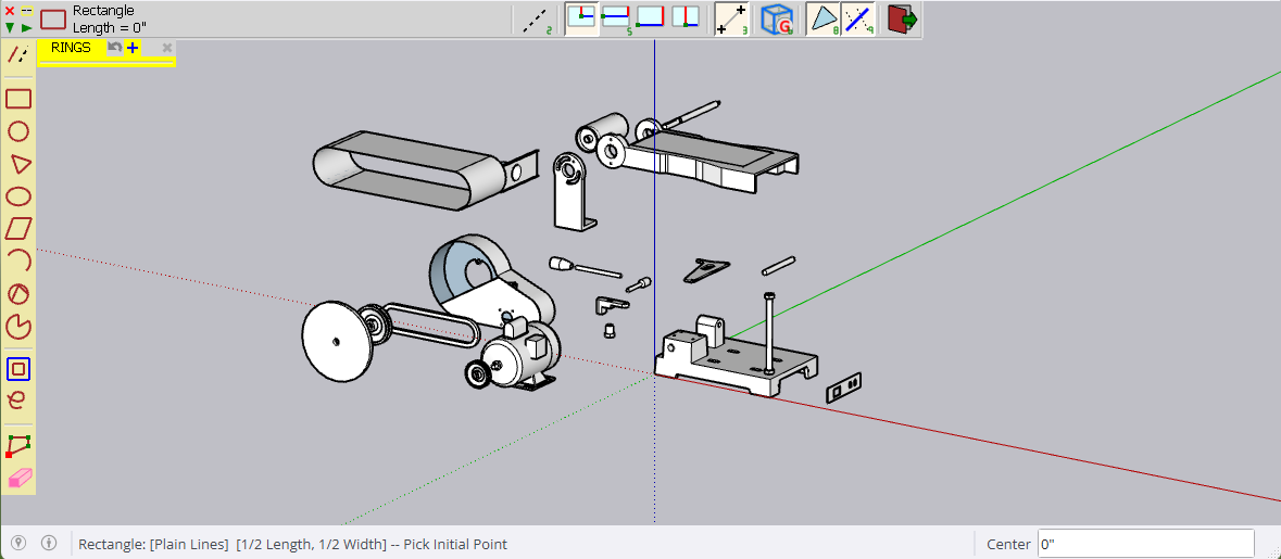

      When I switch to Rectangle on a surface and I am still hovering over the left side menu things look fine.
      It's when I leave the menu thing begin to look a bit wonky. I lose a button on the left and my options along the top disappear. And as mentioned before, now Point Cursor.
