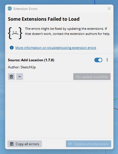

Add Location Failed To Load
Any ideas?
Here is the error code.
Extension Errors Report
SketchUp: 25.0.634
OS: Windows 11
Ruby: 3.2.2Extension: Add Location (1.7.8)
Error: Failed to load file (Could not find included file 'c:/users/elay/appdata/roaming/sketchup/sketchup 2025/sketchup/plugins/habitat_site_context/lib/v2/protocol/message-json/json_encoder')
c:/users/elay/appdata/roaming/sketchup/sketchup 2025/sketchup/plugins/habitat_site_context/lib/habitatsitecontext.rbe:87:inload_file' c:/users/elay/appdata/roaming/sketchup/sketchup 2025/sketchup/plugins/habitat_site_context/lib/habitatsitecontext.rbe:57:inload_content'
c:/users/elay/appdata/roaming/sketchup/sketchup 2025/sketchup/plugins/habitat_site_context/lib/habitatsitecontext.rbe:95:in<module:HabitatSiteContext>' c:/users/elay/appdata/roaming/sketchup/sketchup 2025/sketchup/plugins/habitat_site_context/lib/habitatsitecontext.rbe:1:in<main>'
c:/users/elay/appdata/roaming/sketchup/sketchup 2025/sketchup/plugins/habitat_site_context/main.rbe:6:ineval' c:/users/elay/appdata/roaming/sketchup/sketchup 2025/sketchup/plugins/habitat_site_context/main.rbe:6:inrequire'
c:/users/elay/appdata/roaming/sketchup/sketchup 2025/sketchup/plugins/habitat_site_context/main.rbe:6:in<module:HabitatSiteContext>' c:/users/elay/appdata/roaming/sketchup/sketchup 2025/sketchup/plugins/habitat_site_context/main.rbe:1:in<main>'
C:/Program Files/SketchUp/SketchUp 2025/SketchUp/Tools/extensions.rb:197:ineval' C:/Program Files/SketchUp/SketchUp 2025/SketchUp/Tools/extensions.rb:197:inrequire'
C:/Program Files/SketchUp/SketchUp 2025/SketchUp/Tools/extensions.rb:197:inload' C:/Users/elay/AppData/Roaming/SketchUp/SketchUp 2025/SketchUp/Plugins/habitat_site_context.rb:20:inregister_extension'
C:/Users/elay/AppData/Roaming/SketchUp/SketchUp 2025/SketchUp/Plugins/habitat_site_context.rb:20:in<module:HabitatSiteContext>' C:/Users/elay/AppData/Roaming/SketchUp/SketchUp 2025/SketchUp/Plugins/habitat_site_context.rb:4:in<top (required)>' -
@boofredlay said in Add Location Failed To Load:
Check that the file exists...
I was nosy and poked around until I found it. Here is the .json. I hope pasting it into that folder fixes it for you.
Thanks Dave.
Now it cannot load because it can't find:
json_numeric_encoder -
Well I checked online and there was a newer build for 2025 since my last install so I just installed that and it fixed my issue.
Thanks for the assistance guys.
